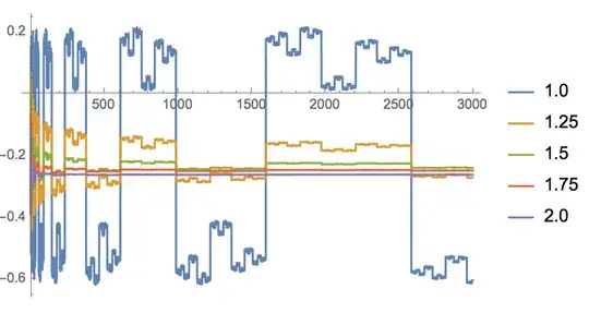

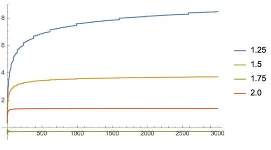

Numerical experimentPartial Sum of the SummandPartial Sum of the abs of Summand

Numerical calculation suggests $\sum_{n\le x}|\cot\varphi\pi n|=\Theta(x\log x)$. If we can prove this conjecture, we can obtain the absolute convergence of the series with condition $\Re s>1$ by using Abel's transformation.

17.04.19 $4 Structure of the partial sum

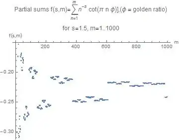

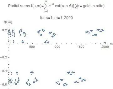

The following plots show the partial sum for a certain range of $m$ for the critical case $s=1$, for $=1.1$, and for $s=1.5$
For $s=1$ we see that the partial sums form strata of clouds, of finite width vertically as well as horizontally. The partial sums oscillate between the upper and the lower stratum. Hence the sum is divegent.
For $s=1.1$ the upper and lower bands of clusters tend to approach each other thus pointing to convergence.
Here, at $s=1.5$ convergence is obvious.

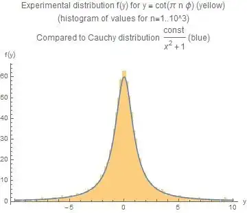

In order to see more clearly the relevance of this analogy we ask for the statistical properties of the numerator $u=\cot(v)$ with $v=\pi n \phi$, and $\phi$ the golden ratio.
It is clear that the value of $u$ depends only on the fractional part of $w=\{v\}$ of $v$. Now looking at the frequency distribution of $w$ and the first two moments are numerically close to $\frac{1}{2}$ (mean) and $\frac{1}{12}$ (variance), respectively, it seem reasonable to approximate $w$ by a true random variable $R$ with a PDF
$f_r(r) = \left\{ \begin{array}{ll} \frac{1}{\pi} & 0\le r\le \pi\\ 0& \text{else} \\ \end{array} \right. $
The distribution of $T = \cot(R)$ follows from $r = \text{arccot}(t)$ and $f(r) dr = f(r(t))(\frac{dr}{dt}) dt$ and results in the Cauchy distribution
$$f_{t}(t) = \frac{1}{\pi} \frac{1}{1+t^2}$$
The graph compares the experimental distribution of $u$ for $10^4$ consecutive values of $n$ with the Cauchy distribution.

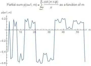

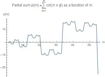

Here is the graph of a partial sum of $\cot(n \pi \phi)$
We observe two salient features
a) the change of the sign cuts the curve into pieces of incresing width
b) these pieces exhibit a self similar structure
First we try to find the position of the zeros of the curve. Close inspection of the interval depicted show that $p(1) < 0$, $p(2) > 0$, $p(3)\lt0$, $p(5) > 0$ and so on. We define a zero of the function to be the lower index of the sign change.
Hence the list of zeroes starts as follows $(1,2,3,5, 8, 13, 22, 35, 53, ...)$.
We recongnize this as the sequence of the well-known Fibonacci numbers, and we conjecture that this observation holds generally: the zeroes are located at the Fibanacci numbers $F(n)$.
In hindsight it is no wonder that Fibonacci numbers appear in a series employing the golden ratio which is approximated by the ratio $\phi \simeq F(n+1)/F(n)$.

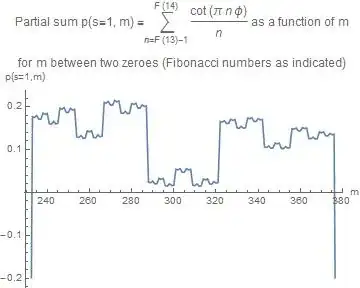

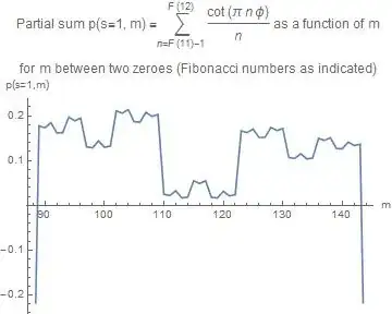

We now plot the partial sum between two zeroes given by $n=F(k)-1$ and $n=F(k+1)$, and compare the cases $k=11$ and $k=13$ graphically
We observe that the curves have the same appearance, but in a different interval, and the structure of the curve has become more fine structured.

  • I followed your step to do some other numerical experiment and I added it to the question body. Hope you don't mind. – Kemono Chen Apr 13 '19 at 11:18
  • No, I don't mind, of course, but you could mention my Investigation. Your line drawing supplements my point drawing. – Dr. Wolfgang Hintze Apr 13 '19 at 11:43
