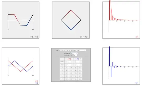

The Fourier series
$$a_k = \begin{cases} +k^{-2} & \text{ for } k \equiv 1 \pmod n \\ +k^{-2} & \text{ for } k \equiv (n-1) \pmod n\\ 0 & \text{ otherwise } \end{cases}$$
$$b_k = \begin{cases} +k^{-2} & \text{ for } k \equiv 1 \pmod n\\ -k^{-2} & \text{ for } k \equiv (n-1) \pmod n\\ 0 & \text{ otherwise } \end{cases}$$
give rise to a regular $n$-gon (with all its symmetries, vertices, and straight edges).

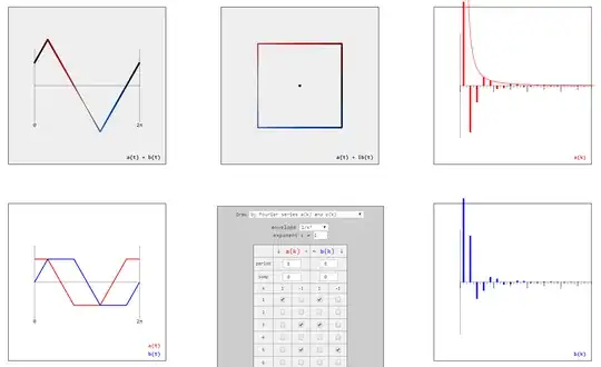

The Fourier series
$$a_k = \begin{cases} +k^{-2} & \text{ for } k \equiv 1 \pmod {2n} \\ -k^{-2} & \text{ for } k \equiv (n-1) \pmod {2n}\\ -k^{-2} & \text{ for } k \equiv (n+1) \pmod {2n}\\ +k^{-2} & \text{ for } k \equiv (2n-1) \pmod {2n}\\ 0 & \text{ otherwise } \end{cases}$$
$$b_k = \begin{cases} +k^{-2} & \text{ for } k \equiv 1 \pmod {2n} \\ +k^{-2} & \text{ for } k \equiv (n-1) \pmod {2n}\\ -k^{-2} & \text{ for } k \equiv (n+1) \pmod {2n}\\ -k^{-2} & \text{ for } k \equiv (2n-1) \pmod {2n} \\ 0 & \text{ otherwise } \end{cases}$$
give rise to a regular $n$-gon rotated by $\pi/n$.

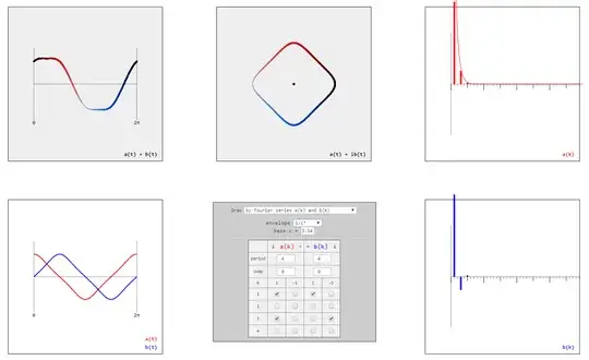

The Fourier series
$$a_k = \begin{cases} +\gamma^{-k} & \text{ for } k \equiv 1 \pmod 4 \\ +\gamma^{-k} & \text{ for } k \equiv 3 \pmod 4\\ 0 & \text{ otherwise } \end{cases}$$
$$b_k = \begin{cases} +\gamma^{-k} & \text{ for } k \equiv 1 \pmod 4\\ -\gamma^{-k} & \text{ for } k \equiv 3 \pmod 4\\ 0 & \text{ otherwise } \end{cases}$$
with $\gamma = \sqrt{2+2\sqrt{3}+\sqrt{15+8\sqrt{3}}}=3.291795...$ gives rise to a square with rounded corners.
Further examples are welcome.
I wrote a little tool to play around with Fourier series and compare them with the shapes they give rise to. The following gallery shows by some simple examples what can be done and observed with it. If you are interested in using it by yourself, just drop me an email.
