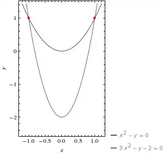

I will first concentrate on example 1. You actually used two tangent hyperbolae. That might gives some numerical error when computing the intersection using a numerical algorithm (like the one I wrote for Matlab www.mathworks.it/matlabcentral/fileexchange/28318-conics-intersection).
Let's consider two well intersecting parabolae like: $$C_1 = \begin{bmatrix}1 & 0 & 0\\0 & 0 & -1/2\\0 & -1/2 & 0\end{bmatrix}$$ $$C_2 = \begin{bmatrix}3 & 0 & 0\\0 & 0 & -1/2\\0 & -1/2 & -2\end{bmatrix}$$
whose equations are $x^2 - y = 0$ and $3x^2 - y - 2 = 0$ respectively. The intersection can be seen in the following plot:
The two intersecting conics
It is possible to verify that these two conics intersects in two points $$p_1 = \begin{bmatrix}-1 & 1 & 1\end{bmatrix}$$ $$p_2 = \begin{bmatrix} 1 & 1 & 1\end{bmatrix}$$ expressed in homogeneous coordinates.
