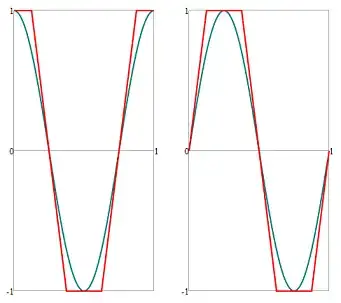

It's an easy exercise to approximate the cosine and the sine function by a piecewise linear function on the unit interval $[0,1]$. Let $\tau = 2\pi$.
Let
$$\boxed{\cos_\bigcirc(x) = \cos(\tau x)\\\sin_\bigcirc(x) = \sin(\tau x)}$$
and compare this to
$$\boxed{\cos_\square(x) = \begin{cases} +1 & \text{ for } \frac{0}{8} \leq x \leq \frac{1}{8} \\ +2 - 8x & \text{ for } \frac{1}{8} \leq x \leq \frac{3}{8} \\ -1 & \text{ for } \frac{3}{8} \leq x \leq \frac{5}{8} \\ -6 + 8x & \text{ for } \frac{5}{8} \leq x \leq \frac{7}{8} \\ +1 & \text{ for } \frac{7}{8} \leq x \leq \frac{8}{8} \\ \end{cases} \\ \\\sin_\square(x) = \begin{cases} +0 + 8x & \text{ for } \frac{0}{8} \leq x \leq \frac{1}{8} \\ +1 & \text{ for } \frac{1}{8} \leq x \leq \frac{3}{8} \\ +4 - 8x & \text{ for } \frac{3}{8} \leq x \leq \frac{5}{8} \\ -1 & \text{ for } \frac{5}{8} \leq x \leq \frac{7}{8} \\ -8 + 8x & \text{ for } \frac{7}{8} \leq x \leq \frac{8}{8} \\ \end{cases}}$$
These are the plots:

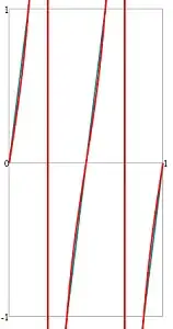

  • The tangens $\tan_\bigcirc(x) = \tan(\tau x)$ is very well approximated already by $\tan_\square(x) = \frac{\sin_\square(x)}{\cos_\square(x)}$:

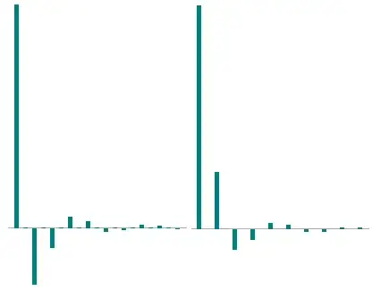

  3. Is there a closed formula for the Fourier transform of $\cos_\square(x)$ and $\sin_\square(x)$ (the "Fourier transform of the quadrature of the circle")?
This is how the Fourier transforms of $\cos_\square(x)$ and $\sin_\square(x)$ look like: enter image description here
Summary
Thanks to user J.M. we now know the Fourier coefficients $\widehat{\cos}_\square(k)$
$$\boxed{\widehat{\cos}_\square(k) = 8 \cdot \begin{cases} \ \ \ \ \ 0 & \text{ for } k \equiv 0 \mod 2 \\ +(\pi k)^{-2} & \text{ for } k \equiv 1 \mod 8 \text{ or } k \equiv 7 \mod 8\\ -(\pi k)^{-2} & \text{ for } k \equiv 3 \mod 8 \text{ or } k \equiv 5 \mod 8\\ \end{cases}}$$
and $\widehat{\sin}_\square(k)$ accordingly.

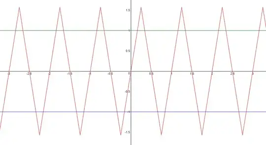

To those who don't have the function $f(x) = \arcsin(\sin(2\pi x))$ before their inner eye, this is how it looks like:
It's essentially this function that user J.M. cuts off at $\min = -1$ and $\max = +1$ to yield $\sin_\square(x)$.
