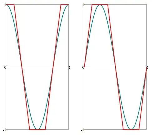

Consider "piecewise linear approximations" of the sine and cosine function, periodically defined on the unit interval, i.e. $x \in [0,1]$.
Let
$$\boxed{\cos_\bigcirc(x) = \cos(2\pi x)\\\sin_\bigcirc(x) = \sin(2\pi x)}$$
and compare this to
$$\boxed{\cos_\square(x) = \begin{cases} +1 & \text{ for } \frac{0}{8} \leq x \leq \frac{1}{8} \\ +2 - 8x & \text{ for } \frac{1}{8} \leq x \leq \frac{3}{8} \\ -1 & \text{ for } \frac{3}{8} \leq x \leq \frac{5}{8} \\ -6 + 8x & \text{ for } \frac{5}{8} \leq x \leq \frac{7}{8} \\ +1 & \text{ for } \frac{7}{8} \leq x \leq \frac{8}{8} \\ \end{cases} \\ \\\sin_\square(x) = \begin{cases} +0 + 8x & \text{ for } \frac{0}{8} \leq x \leq \frac{1}{8} \\ +1 & \text{ for } \frac{1}{8} \leq x \leq \frac{3}{8} \\ +4 - 8x & \text{ for } \frac{3}{8} \leq x \leq \frac{5}{8} \\ -1 & \text{ for } \frac{5}{8} \leq x \leq \frac{7}{8} \\ -8 + 8x & \text{ for } \frac{7}{8} \leq x \leq \frac{8}{8} \\ \end{cases}}$$
or written more readable:
$$\cos_\square(x) = \begin{cases} +1 & \text{ for } 0 \leq 8x \leq 1 \\ +2 - 8x & \text{ for } 1 \leq 8x \leq 3 \\ -1 & \text{ for } 3 \leq 8x \leq 5 \\ -6 + 8x & \text{ for } 5 \leq 8x \leq7 \\ +1 & \text{ for }7 \leq 8x \leq 8 \\ \end{cases} \\ \\\sin_\square(x) = \begin{cases} +0 + 8x & \text{ for } 0 \leq 8x \leq 1 \\ +1 & \text{ for } 1 \leq 8x \leq 3 \\ +4 - 8x & \text{ for } 3 \leq 8x \leq 5 \\ -1 & \text{ for } 5 \leq 8x \leq7 \\ -8 + 8x & \text{ for }7 \leq 8x \leq 8 \\ \end{cases}$$
These are the plots:
$\cos_\square$ and $\sin_\square$ are especially well suited to arrange numbers on a square with integer coordinates around the origin with uniform distance $1$ along the square.
