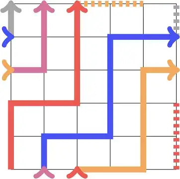

So for $n=m=5$ as input, this would be one of the valid paths:
It starts at the $[0,0]$ origin in the bottom-left and follows the red → orange → pink → blue → grey arrows, ending up back at $[0,0]$ without having visited any other coordinate more than once.
Two other valid paths would be to simply move up five times or move right five times.

  • So arriving at any corner is the same as arriving at $(0,0)$? Are the "dotted" edges forbidden? E.g., would the path $(0,0)$, $(0,2)$, $(5,2)$, $(5,5)$ not be allowed? – Jens Mar 12 '19 at 20:42
  • @Jens I'm not sure why the dotted edges are there tbh. Probably as an indication that they are both at the top and bottom, or left and right side, at the same time. The person who posted the code-golf challenge made that picture. As for your other question: yes, I indeed believe any of the four corners is a valid finishing point, since $(5,5)$ on a 5 by 5 grid, will be $(0,0)$ when modulo-5 is used. The main hard part about this problem are the lines that wrap-around through the sides, and how it can increase the number of possible paths from $(0,0)$ to any of the corners. – Kevin Cruijssen Mar 12 '19 at 22:55
