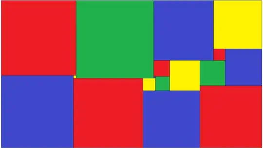

I looked through some of the data on Squaring.Net (actually, copies at the Internet Archive, since the site is currently down), and there is no $1366\times768$ simple perfect squared rectangle of order $17$ or less; there may be one of higher order, but that's harder to check. But there is a $1354\times764$ simple perfect squared rectangle of order $17$, so if you can accept a six-pixel border on the left and right and a two-pixel border at the top and bottom, this will do the job. It looks like this:
1354x764 squared rectangle (Click on the image for the full-size version.)
The Bouwkamp code for this rectangle dissection is $17\ 1354\ 764\ (389, 403, 311, 251)\ (60, 191)\ (83, 157, 131)\ (375, 14)\ (9, 74)\ (361, 65)\ (322)\ (296)$.

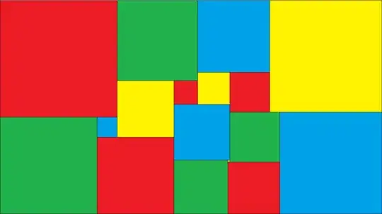

EDIT: As Servaes points out, I overlooked an even better $1366\times766$ alternative, also of order $17$:
1366x766 squared rectangle
Its Bouwkamp code is $17\ 1366\ 766\ (419, 288, 258, 401) (115, 143) (203, 85) (200) (179, 365) (347, 72) (275) (193, 7) (186)$.

    There seems to be a $1366\times766$ rectangle in the linked file as well. – Servaes Mar 08 '19 at 15:22
  • @Servaes I missed that one. It's definitely better than the one I did notice. I'll add it. – FredH Mar 08 '19 at 15:45
  • I find the $1366\times766$ arrangement especially aesthetically pleasing. I should hope a similar configuration exists for the $1366\times768$ rectangle... – Servaes Mar 09 '19 at 01:13
