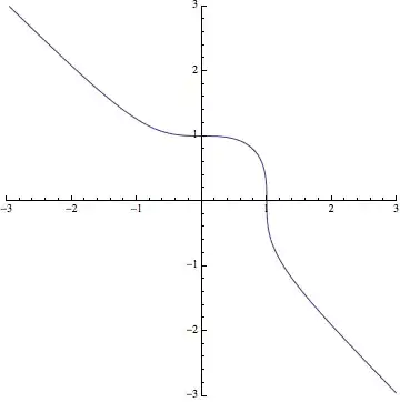

If you take something more crazy like $g(x) = x^3 - a/2$, you get:
$$g^{-1}(-g(x)) = \left(-\left(x^3 - \frac{a}{2}\right) + \frac{a}{2}\right)^{\frac13} = (a - x^3)^{\frac13}$$
A very strange looking curve but still a continuous solution for the equation $f(f(x)) = x$.
$y = (1-x^3)^{1/3}$
Credit above graph comes from $\mathbb{R}^n$ which exhibit the $x \leftrightarrow y$ symmetry explicitly.
achille hui
  • 125,323
  • Here is the same graph with a 1:1 aspect ratio, if you want to include in your answer. –  Feb 25 '13 at 08:07
  • @Rn, thanks for the graph. – achille hui Feb 25 '13 at 08:41
