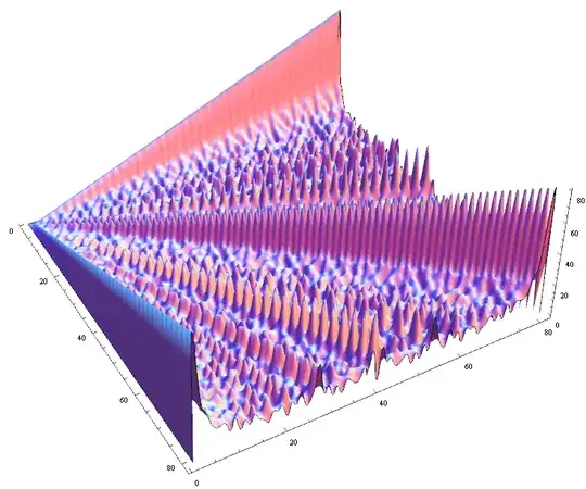

A plot of the subtractions-required looks like this:
data = Table[gcd[i, j][[2]], {i, Range[0, 80]}, {j, Range[0, 80]}];
ListPlot3D[data, InterpolationOrder -> 2, Mesh -> None, Boxed -> False, PlotRange -> Full]
I know this is not exactly what you're looking for, but I wanted to bring in the computational perspective. :)

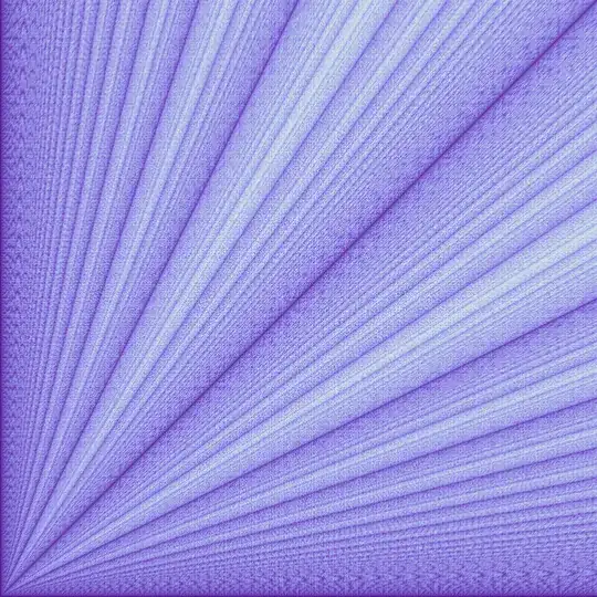

data = Table[gcd[i, j][[2]], {i, Range[0, 599]}, {j, Range[0, 599]}];
Because the algorithm is fast (Max[data] shows that any two numbers between 0 and 599 will resolve in at most 12 steps), the value jumps rapidly between only a few discrete values (0-12), which makes a regular 3D plot very noisy. So I used a density plot instead:
ListDensityPlot[data, ImageSize -> {600, 600}, PlotRangePadding -> None, Frame -> None, Axes -> False]

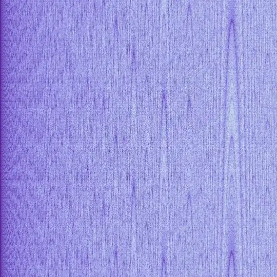

Here's a "close-up" achieved by plotting in a different range:
data = Table[gcd[i, j][[2]], {i, Range[250949, 250949 + 599]}, {j, Range[0, 599]}];

But in Euclid's algorithm you always subtract the largest possible multiple of the smaller number in one step. It would be interesting to see that plot (IMHO upvote worthy). I would expect the golden ratio to show there. – Jyrki Lahtonen Feb 22 '13 at 21:55
I added some plots along those lines. I'm curious though why or in what way you expect the golden ratio to show itself (whether it's the case or not). – amr Feb 23 '13 at 05:13
1+1: I expect the Golden ratio to show up, because $\gcd(F_n,F_{n+1})$ has the worst case complexity in Eucliden algorithm, so the lines with slopes $\phi^{\pm1}$ might be visible as high complexity regions. They sorta do, but not nearly as clearly as I hoped. – Jyrki Lahtonen Feb 23 '13 at 06:43
