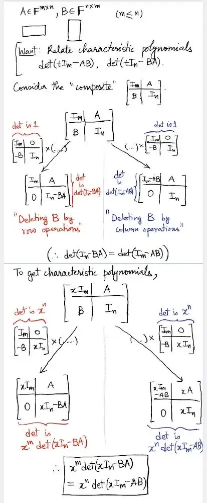

[The result follows from ${ m = n }$ case of the argument here]
Additional lensdump link: https://lensdump.com/i/sChcBM
[Same argument expanded]
Let ${ A \in \mathbb{F} ^{m \times n}, B \in \mathbb{F} ^{n \times m} }$ with ${ m \leq n }.$ Goal is to relate characteristic polynomials of ${ AB, BA }.$
Consider the composite matrix ${ \begin{pmatrix} I _m &A \\ B &I _n \end{pmatrix}. }$
Deleting ${ B }$ using row operations gives $${ \begin{pmatrix} I _m &0 \\ -B &I _n\end{pmatrix} \begin{pmatrix} I _m &A \\ B &I _n \end{pmatrix} = \begin{pmatrix} I _m &A \\ 0 &{\color{green}{I _n - BA}}\end{pmatrix} }.$$Deleting ${ B }$ using column operations gives $${ \begin{pmatrix} I _m &A \\ B &I _n \end{pmatrix} \begin{pmatrix} I _m &0 \\ -B &I _n \end{pmatrix} = \begin{pmatrix} {\color{purple}{I _m - AB}} &A \\ 0 &I _n \end{pmatrix}. }$$ To compare characteristic polynomials, one would want the green entry to be ${ {\color{green}{x I _n - BA}} }$ and purple entry to be ${ {\color{purple}{x I _m - AB}} }$ instead.
So the following modification of above two equations works: $${ \begin{pmatrix} I _m &0 \\ -B &{\color{green}{x}}I _n \end{pmatrix} \begin{pmatrix} {\color{purple}{x}}I _m &A \\ B &I _n \end{pmatrix} = \begin{pmatrix} x I _m &A \\ 0 &{\color{green}{x I _n - BA}}\end{pmatrix}, }$$ and $${ \begin{pmatrix} {\color{purple}{x}}I _m &A \\ B &I _n \end{pmatrix} \begin{pmatrix} I _m &0 \\ -B &{\color{green}{x}}I _n \end{pmatrix} = \begin{pmatrix} {\color{purple}{x I _m - AB}} &xA \\ 0 &xI _n \end{pmatrix} .}$$Taking determinants gives $${ x ^m \det({\color{green}{x I _n - BA}}) = x ^n \det({\color{purple}{x I _m - AB}}) }$$ as needed.

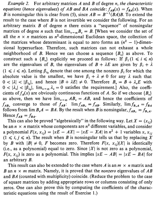

The following are two proofs by Ichiro Satake:
佐武五郎
  • 1,718
