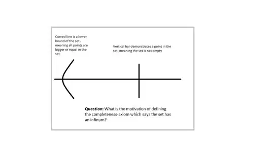

I don't understand what was the Motivation for the completeness Axiom and why Analysis and calculus would not work without it:

1Okey this was really helpfull to fuel my Intuition About this Topic. I am just rephrasing what you were saying but if I take the above set which is bounded from below and not empty I can theoretically Always look at a Point between the Bound and the Point that I know that exists and test if it is in the set or not. If not then this Point is a lower Bound otherwise if I would say if it is not a lower Bound then there must be a Point that is smaller than the Point in Question which is called a lower Bound but such apoint cannot exist because the Point in Question is not in the set. – New2Math Feb 10 '19 at 18:52
1If it is in the set then I go down, if it is not in the set I go up. Rinse and repeat this is a Limit process. – New2Math Feb 10 '19 at 18:53
That's the rough idea! The general result is this: Every bounded set contains a sequence that approaches its infimum (or supremum). – Robert D-B Feb 10 '19 at 19:32
