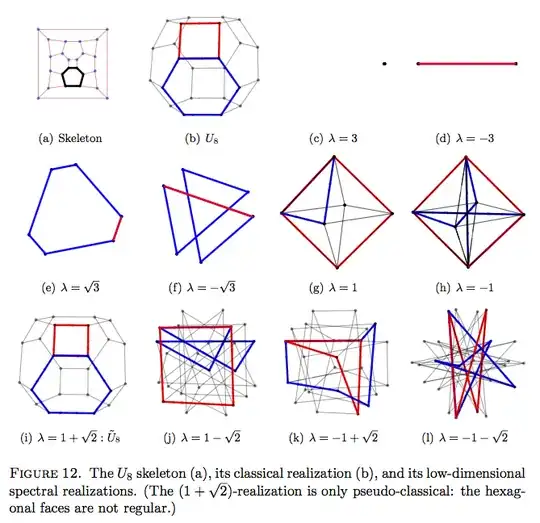

I can't speak much to what traditional Spectral Graph Theory is about, but my personal research has included the study of what I call "Spectral Realizations" of graphs. A spectral realization is a special geometric realization (vertices are not-necessarily-distinct points, edges are not-necessarily-non-degenerate line segments, in some $\mathbb{R}^n$) derived from the eigenvectors of a graph's adjacency matrix.
In particular, if the rows of a matrix constitute a basis for some eigenspace of the adjacency matrix a graph $G$, then the columns of that matrix are coordinate vectors of (a projection of) a spectral realization.
A spectral realization of a graph has two nice properties:
  • It's harmonious: Every graph automorphism induces to a rigid isometry of the realization; you can see the graph's automorphic structure!
  • It's eigenic: Moving each vertex to the vector-sum of its immediate neighbors is equivalent to scaling the figure; the scale factor is the corresponding eigenvalue.
Well, the properties are nice in theory. Usually, a spectral realization is a jumble of collapsed segments, or is embedded is high-dimensional space; such circumstances make a realization difficult to "see". Nevertheless, a spectral realization can be a helpful first pass at visualizing a graph. Moreover, a graph with a high degree of symmetry can admit some visually-interesting low-dimensional spectral realizations; for example, the skeleton of the truncated octahedron has this modestly-elaborate collection:
Spectral Realizations of the Truncated Octahedron
For a gallery of hundreds of these things, see the PDF linked at my Bloog post, "Spectral Realizations of Graphs".
Since many mathematical objects decompose into eigen-objects, it probably comes as no surprise that any geometric realization of a graph is the sum of spectral realizations of that graph. (Simply decomposing the realization's coordinate matrix into eigen-matrices gets most of the way to that result, although the eigen-matrices themselves usually represent "affine images" of properly-spectral realizations. The fact that affine images decompose into a sum of similar images takes an extension of a theorem of Barlotti.) There's likely something interesting to be said about how each spectral component spectral influences the properties of the combined figure.
Anyway ... That's why I care about the eigenvalues of graphs.
