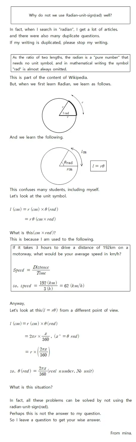

There are a several answers to your question to be found here. – Lee Mosher Jan 26 '19 at 17:25
$\text {cm} \times \text {rad}=\text {cm}$ because $\text{rad}$ is a dimensionless constant. – For the love of maths Jan 26 '19 at 17:26
4And, by the way, entering your question by pasting in an image is not a good way to use this site. See here for how to use markup language to format text, and see here for how to use mathjax to format mathematics. – Lee Mosher Jan 26 '19 at 17:29
1Please write the question as text and not just embed everything in a huge image. This is no good for visually impaired users, search engines, etc. In fact you have been asked not to do this in previous questions, but you are still doing it. – Jan 26 '19 at 17:29
2Meanwhile, I am voting to close as a duplicate of Why radian is dimensionless? – Lee Mosher Jan 26 '19 at 17:29
The best proof that the angular unit "radian" is not evident is that it has taken a long long time before it is widely accepted, and even a longer time before it is more used than degrees (it is only in the second half of the 20th century that engineers where trained to use radians as well as degrees). But the interest of radians is in particular in their use with fractions of $\pi$ : $\sin(0.7854)$ doesn't sound interesting, whereas $\sin(\pi/4)$ is. – Jean Marie Jan 26 '19 at 18:02
