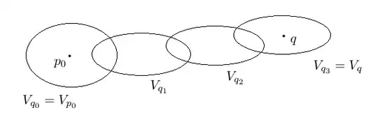

Now fix $p_0\in X$. Since $X$ is connected, for any $q\in X$ there are points $p_0=q_0,...,q_k=q$ such that $V_{q_i}\cap V_{q_{i+1}}\neq\emptyset$. Let's call $\{V_{q_0},...,V_{q_k}\}$ a "bridge of lenght $k$" between $V_{p_0}$ and $V_q$.
The minimum length of that bridge will be called $\ell(V_q)$, and this defines a function $\ell:\mathcal{C}\to \mathbb{Z}_{\geq 0}$. We will show that $\ell^{-1}(n)$ is finite $\forall n\geq 0$, which proves $\mathcal{C}$ is enumerable. Of course $\ell^{-1}(0)=\{V_{p_0}\}$ is finite. Assuming $\ell^{-1}(0),...,\ell^{-1}(n)$ are finite, let's prove $\ell^{-1}(n+1)$ is finite. Consider the set: $$K:=\bigcup_{\ell(V_q)\leq n}\overline{V_q}$$
$K$ is compact, since there are finitely many such $V_q$'s by the induction hypothesis. Since $\mathcal{C}$ is locally finite, each $p\in K$ has a neighbourhood $W_p$ which intersectes finitely many $V_q$'s. Taking a finite subcover $W_{p_1},...,W_{p_k}$ of $K$, we conclude that $K$ also intersects finitely many $V_q$'s. Finally, take $V_p\in \ell^{-1}(n+1)$ and a bridge $\{V_{p_0}=V_{q_0},...,V_{q_{n+1}}=V_p\}$. Notice that $\ell(V_{q_n})\leq n$, so $V_{q_n}\subset K$ by construction. Since $V_{q_n}\cap V_p\neq \emptyset$, of course $V_p\cap K\neq \emptyset$, so there are finitely many choices for $V_p$. $_\blacksquare$
