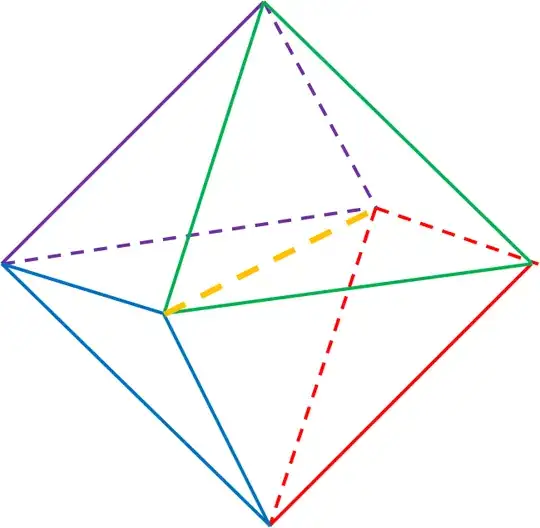

Does anyone know how to calculate the volume of an irregular octahedron from the lengths of the edges?
The octahedron has triangular faces, but the only information are the edge lengths.
Alternatively, how might I calculate the length of a line drawn ( the yellow dashed line) between two opposing vertices? If this known it can be split into 4 irregular tetrahedra.
In the Image the different edge lengths are coour coded, i.e all green edges are length x, blue edges are length y...

Let $w$, $x$, $y$, $z$ be the edge lengths, and let $d$ be a body diagonal. Then $s:=d^2$ satisfies this quartic (barring typos):
$$\begin{align} 0 &= s^4 (-w + x + y + z) (w - x + y + z) (w + x - y + z)(w + x + y - z) \\[4pt] &- 12 s^3 (w x + y z)(w y + x z)(wz+x y) \\[4pt] &+2 s^2 \left(\begin{array}{c} \sigma_1^4 \sigma_2^2 - 4 \sigma_1^2 \sigma_2^3 - 2 \sigma_1^5 \sigma_3 + 8 \sigma_1^3 \sigma_2 \sigma_3 \\ + 8 \sigma_1 \sigma_2^2 \sigma_3 - 10 \sigma_1^2 \sigma_3^2 - 12 \sigma_2 \sigma_3^2 + 8 \sigma_1^4 \sigma_4 \\ - 44 \sigma_1^2 \sigma_2 \sigma_4 + 32 \sigma_2^2 \sigma_4 + 48 \sigma_1 \sigma_3 \sigma_4 - 32 \sigma_4^2 \end{array}\right) \\[4pt] &-4 s (w x + y z)(w y + zx)(wz+xy) \left( \begin{array}{c} 2 \sigma_1^4 - 8 \sigma_1^2 \sigma_2 + 3 \sigma_2^2 + 10 \sigma_1 \sigma_3 - 8 \sigma_4 \end{array}\right) \\[4pt] &-\left(\begin{array}{c} \sigma_1^4 \sigma_2^4 - 4 \sigma_1^2 \sigma_2^5 - 4 \sigma_1^5 \sigma_2^2 \sigma_3 + 16 \sigma_1^3 \sigma_2^3 \sigma_3 \\ + 8 \sigma_1 \sigma_2^4 \sigma_3 + 8 \sigma_1^4 \sigma_2 \sigma_3^2 - 64 \sigma_1^2 \sigma_2^2 \sigma_3^2 + 64 \sigma_1 \sigma_2 \sigma_3^3 \\ - 12 \sigma_3^4 + 8 \sigma_1^6 \sigma_2 \sigma_4 - 48 \sigma_1^4 \sigma_2^2 \sigma_4 + 64 \sigma_1^2 \sigma_2^3 \sigma_4 \\ - 16 \sigma_2^4 \sigma_4 + 64 \sigma_1^3 \sigma_2 \sigma_3 \sigma_4 - 64 \sigma_1 \sigma_2^2 \sigma_3 \sigma_4 - 24 \sigma_1^2 \sigma_3^2 \sigma_4 \\ - 32 \sigma_2 \sigma_3^2 \sigma_4 - 12 \sigma_1^4 \sigma_4^2 - 32 \sigma_1^2 \sigma_2 \sigma_4^2 + 64 \sigma_2^2 \sigma_4^2 \end{array}\right) \end{align} \tag{$\star$}$$ where the $\sigma_i$ are the symmetric polynomials $$\sigma_1 := w + x + y + z \qquad \sigma_2 := w x + w y + w z + x y + x z + y z$$ $$\sigma_3 := w x y + w x z + w y z + x y z \qquad \sigma_4 := w x y z$$
As a sanity check, when $w=x=y=z$ (ie, the octahedron is regular), equation $(\star)$ reduces to $$16 s w^4 (s-2 w^2)^3 = 0$$ with root $s = 2 w^2$ corresponding to $d = w \sqrt{2}$, as expected.

We can think of the solid as four tetrahedra joined along the yellow diagonal, $d$. Writing $V_w$ for the volume of the tetrahedron with an equilateral $w$-colored face, the Cayley-Menger determinant tells us that

  • Hi Blue, thank you for the help. The Quartic equation is useful (), i can calculate the roots for it in python for known w,x,y,z, then get d from that which can be used for volume calculation. How have you derived ()? – Hoffi.D Dec 24 '18 at 14:17

    @Hoffi.D: I derive $(\star)$ w/brute-force coordinatizing. I define the endpoints of the diag as $(0,0,0)$ & $(0,0,d)$; each remaining point looks like $(r \cos\theta, r\sin\theta, s)$, where $r$ is the height of the corresponding triangle relative to "base" $d$, and $s$ is the $z$-coordinate. Then, I write $12$ equations, each relating various parameters to a particular edge-length. (Four like $r^2+s^2=w^2$; four like $r^2+(d-s)^2=x^2$; four law-of-cosines instances, using dihedral angles between those triangles.) From there, I successively eliminate parameters using Resultant. Easy-peasy! – Blue Dec 24 '18 at 16:23
