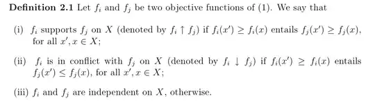

It is my first time that I met the word "entails". In mathematical texts, one usually sees "if and only if", "implies" or "iff" which bear no ambiguity. In the following definition:
Does "entails" mean "implies"? It certainly seems so. Also In one PHD thesis I am reading, the author quotes this definition using the word "implies" instead of the word "entails". So far so good, but next comes a corollary:
But if "entails" means "implies" then this corollary is not true. Since function
$$ f_1 \left( x \right) := x $$
clearly supports
$$ f_2 \left( x \right) := 1 $$
according to the definition above, but not the other way around.
This is because $x' \geq x \Rightarrow 1 \geq 1 $ but $ 1 \geq 1 $ does not imply $x' \geq x $ for all $x', x \in \mathbb{R}$.
What am I missing here?

You are perfectly right, and "entails" certainly should not be taken to mean "is equivalent to". I can just offer one possible explanation for this text: if $\geq$ is a total ordering and an "objective function" is always injective (so "ob" entails "in", I don't know the definition of "objective") then this relation is indeed symmetric. The function $f_2$ in your counterexample is of course not injective.
For in this case, assuming $f_i\uparrow f_j$ and $f_j(x')\geq f_j(x)$, one either has $x'=x$ and therefore $f_i(x')=f_i(x)$, or (by injectivity) $f_j(x')>f_j(x)$, whence (by $f_i\uparrow f_j$) it cannot be that $f_i(x')\leq f_i(x)$, so (by the total ordering) $f_i(x')>f_i(x)$; in summary we get $f_i(x')\geq f_i(x)$ in both cases.
I should add that "$X=\Bbb R^n$" in the citation makes it rather unlikely that objective functions are supposed to be injective. If this is about objective functions in optimization problems, which take their values in $\Bbb R$, then it is almost certainly wrong, as being injective is incompatible with being continuous for $n\geq2$. And for any non-injective objective functions you can do as you did in the counterexample.
  • This seems worth checking! – Tara B Feb 15 '13 at 10:38
  • Thank you! This certainly makes sense. But the authors do not mention injectivity. $f: \mathbb{R}^n \rightarrow \mathbb{R}$ is simply a generic function. – Martin Drozdik Feb 15 '13 at 10:41
  • What does 'objective function of (1)' mean? – Tara B Feb 15 '13 at 11:00
  • It is a generic function $f : \mathbb{R}^n \rightarrow \mathbb{R}$. It is explicitly mentioned that no other assumptions are made. – Martin Drozdik Feb 15 '13 at 11:08
  • That is, objective in the context of optimization. Objective functions are the functions whose supremum or infimum we are looking for. – Martin Drozdik Feb 15 '13 at 11:09
    @MartinDrozdik: OK, so then my answer is not really applicable. It could be that you can save the corollary with some more realistic addition hypothesis on the $f_i$, for instance I think (for $X=\Bbb R^n$) it would be valid when the $f_i$ are piecewise differentiable and nowhere locally constant, or something like that. But even then it is certainly not worth being called a corollary. – Marc van Leeuwen Feb 15 '13 at 11:21
