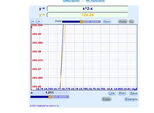

If you mean two graph $H,K$ sharing all the vertices but different edges. Then because they are planar, we have $|E(H)|\leq 3|V(H)|-6$ and $|E(K)|\leq 3|V(K)|-6$.Now, Add those to get $|E(G)|\leq 6|V(G)|-12$. but then $\frac{n(n-1)}{2}=\binom{n}{2}=|E(G)| \leq 6n-12$ which means $n(n-1) \leq 12n-24$. But again left side is quadratic and right is linear and quadratic grows faster than linear. And we can check for $n=11$ we get by substituting into the previous inequality :$110 \leq 108$ which is not possible. And the bigger root of $n^2-13n+24=0$ is $\frac{13 \pm \sqrt{13^2-4*24}}{2}=\frac{13 \pm \sqrt{73}}{2} \approx \frac{13+8}{2} \approx 10.5 $. So anything after the root, you have left side greater than right side.
I hope this is correct. Here is the graph of the function of the two side of inequalities where we can see the the quadratic grows faster than linear after $n \approx 10.77$: enter image description here
