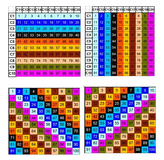

The minimal amount of members has to be 100 or less.
You can observe a distribution for 100 members here
My question:
Is 100 the answer or is there an ever smaller possible amount of members? If so, how can I prove it?
