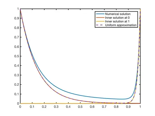

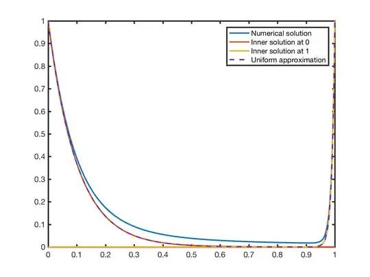

This will not be particularly accurate, it's an $O(\sqrt{\epsilon})$ approximation, but I did verify that numerically. I've made a plot of the solution for $\epsilon=0.01$ first and $\epsilon=0.02$ second.
enter image description hereenter image description here
