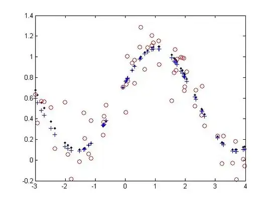

Gauss-Newton algorithm directly deals with this type of problems. Given m data points $(x_i,y_i)$ for regression with a function of n parameters $\vec \beta =(\beta_1,...,\beta_n)$ $$min_{\vec \beta }\ S(\vec \beta)\ where\ S(\vec \beta)=\sum_{i=1}^m r_i(\vec \beta)^2=(y_i-f(\vec \beta,x_i))^2$$ I skip the derivation of algorithm which you can find in every textbook (First use Taylor approximation and then use Newton's method). $$\Delta \vec \beta=\big(J^T\ J\big)^{-1}\ J^T\ \vec r$$ $$\vec \beta=\vec \beta + \alpha\ \Delta \beta$$ where $\alpha$ is damping coefficient and $$J=\begin{pmatrix}\bigg(\frac{\partial f}{\partial \beta_1}\bigg)_{x=x_1}&...&\bigg(\frac{\partial f}{\partial \beta_n}\bigg)_{x=x_1}\\\ ...&...&...\\\ \bigg(\frac{\partial f}{\partial \beta_1}\bigg)_{x=x_m}&...&\bigg(\frac{\partial f}{\partial \beta_n}\bigg)_{x=x_m}\end{pmatrix}\quad \vec r=\begin{pmatrix}y_1-f(\vec \beta,x_1)\\\ ... \\\ y_m-f(\vec \beta,x_m) \end{pmatrix}$$ For your specific case $$\frac{\partial f}{\partial A}=sin(Bx_i+C)$$ $$\frac{\partial f}{\partial B}=Ax_icos(Bx_i+C)$$ $$\frac{\partial f}{\partial C}=Acos(Bx_i+C)$$ $$\frac{\partial f}{\partial D}=1$$
In Matlab I generated 60 uniformly distributed random sample points. I used these points to calculate a known sin-curve such as $$y=0.5sin(1.2x+0.3)+0.6$$ I added error terms N(0,0.2) to each point. My initial guess was $A=0.1\ B=0.5\ C=0.9\ D=0.1$ and I set the damping coeff to 0.01. The algorithm determines below approximation equation after 407 iterations $$\hat y=0.497sin(1.178x+0.352)+0.580$$ Below you can see the graph (black - original curve $y(x)$, red - curve with error terms $y(x)+\epsilon (x)$, blue - approximation curve $\hat y(x)$)

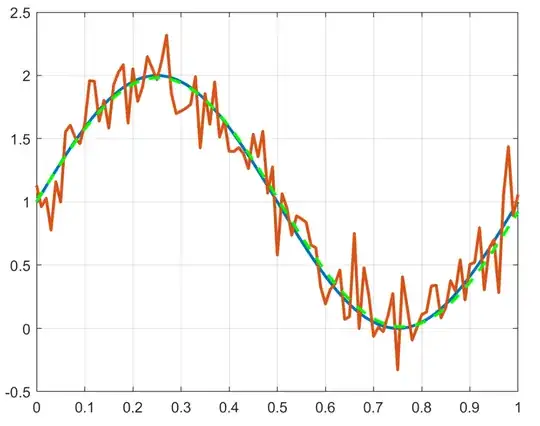

As the function is nonlinear, nonlinear regression can be used here. As has been mentioned in other answers, the Gauss–Newton algorithm can be used here. Let $$ f(x) = A\sin(Bx+C)+D. $$
The key point here is to expand the nonlinear model using the Taylor series.
$$ f(x_i)_{j+1} = f(x_i)_j + \frac{\partial f(x_i)_j}{\partial A} \Delta A + \frac{\partial f(x_i)_j}{\partial B} \Delta B+ \frac{\partial f(x_i)_j}{\partial C} \Delta C + \frac{\partial f(x_i)_j}{\partial D} \Delta D. $$
For example, let $A=1,B=2\pi,C=0,D=1$, $$ f(x) = \sin(2\pi x) + 1. $$
To simulate this example, I will add some noise to $f(x)$ with $\mathcal{N}(0,\sigma^2)$ where $\sigma=0.2$.
x=0:0.01:1;
x=x';
A=1;B=2*pi;C=0;D=1;
f=A*sin(B*x+C)+D;
noise = 0.2*randn(numel(x),1);
y = f + noise; % measurement data
Using the Gauss-Newton method, the estimates for $A,B,C,D$ are
% initial guess
A0=0.9;
B0=1.8*pi;
C0=0.08;
D0=0.95;
K=[A0;B0;C0;D0];
f0=A0*sin(B0*x+C0)+D0;
W=y-f0;
dfdA = sin(B*x+C);
dfdB = A*x.*cos(B*x+C);
dfdC = A*cos(B*x+C);
dfdD = ones(numel(x),1);
Z = [dfdA dfdB dfdC dfdD]; K = K + (Z'Z)\Z'W; % K(1)=A,K(2)=B,K(3)=C,K(4)=D.
The results $A=0.9851, B=6.1981,C=0.0077,D=0.9972$. Finally, I generate the estimate and plot the results,
ye=K(1)*sin(K(2)*x+K(3))+K(4);
plot(x,f,x,y,x,ye,'g--','lineWidth',2)
grid on
Not that bad I guess.
