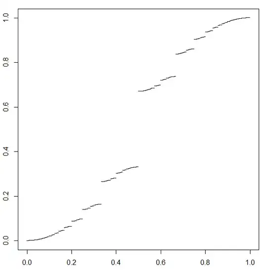

Here is an example related to an earlier question.
Let's write each rational $q \in \mathbb Q \cap(0,1)$ as $q=\frac ab$ where $0 < a < b$ are coprime integers and let $$F(x)=\sum\limits_{\frac ab \le x} \frac{\zeta(3)}{\zeta(3-1)-\zeta(3)}\frac1{b^3}.$$
If it helps, $\frac{\zeta(3)}{\zeta(3-1)-\zeta(3)} \approx 2.7142$. You could replace all the $3$s with anything strictly greater than $2$ and get a similar result.
Then you can say
  • $F(0)=0$,
  • $F(1)=1$,
  • $F(x)$ has a jump up proportional to $\frac1{b^3}$ at each rational $q=\frac ab$ in $(0,1)$,
  • $F(x)$ is continuous and has derivative $0$ at each irrational,
  • $F(x)$ is weakly increasing and right-continuous throughout,
  • $F(x)$ is the cumulative distribution function of a random variable with dense discrete support,
  • $F(x)$ looks like
F(x) chart
and you can see the discontinuities at the simpler rationals, while at other rationals the discontinuities are present but too small to see.

  • I assume you produced the plot by enumerating all rationals with a denominator of up to some integer. Is there a closed-form analytical expression or approximation for the CDF $F$? – paperskilltrees Jun 28 '25 at 04:53
  • I think you can say that $F(x)$ is strictly increasing, not just weakly increasing, because there is at least one rational between $x_1$ and $x_2>x_1$, and so $F(x_2)-F(x_1)>b^{-3}$, where $b$ is the reduced denominator of this rational. – paperskilltrees Jun 28 '25 at 05:07
    @paperskilltrees - I have not found anything in a closed form, exact or an approximation. It is indeed strictly increasing but I only needed it to be weakly increasing and right-continuous between $0$ and $1$ to be a CDF. – Henry Jun 28 '25 at 08:41
