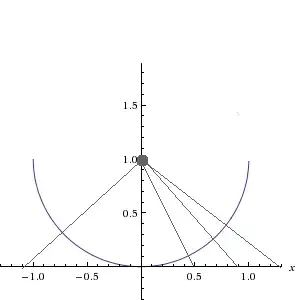

Let's do a fundamentally different approach. Consider projecting from the open bottom half of the circle $x^2 + (y-1)^2 = 1$, as I drafted below.
In this, by projecting from $(0,1)$, we get a 1-1 correspondence from the angle $(0, -\pi) \to \mathbb{R}$. There is a clear 1-1 correspondence from $(0,1)$ and $(0, -\pi)$.
Thus we have our bijection from $(0,1)$ to $\mathbb{R}$. For $[0,1]$, we could use big theorems, or we could just modify this one. So let's "make space" by saying that whatever was associated to $0$ is now associated to $2$, what was associated to $1$ is now associated to $3$, $2$ now goes to $4$, and so on, effectively freeing up the real numbers $0,1$ by displacing the natural numbers. Send $0$ to $0$, and $1$ to $1$, and now we have a bijection $[0,1] \to \mathbb{R}$.
Nice, direct, and constructive.
