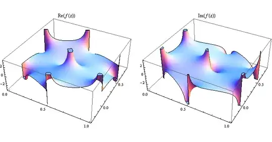

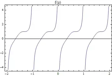

As promised, here are plots of $f(z)$ on the real line:

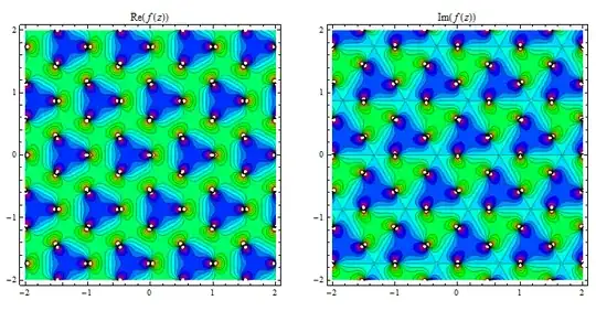

a contour plot of the real and imaginary parts of $f(z)$:

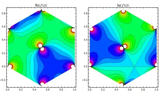

and plots of a single "hexagonal tile" of $f(z)$:
Plots of $g(z)$ are similar since $g(z)=f(-z)$.
