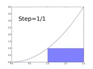

To observe this, you can try with a function. Say $f(x) = x^2$ and you would want to calculate the area between $x = 0$ and $x = 2$. Keep increasing $n$ and see what happens. (I’ll show left-hand side values. Right-hand side will also converge to the same value.)
$$n = 1 \implies A = 0$$
$$n = 2 \implies A = 1$$
$$n = 4 \implies A = 1.75$$
$$n = 8 \implies A = 2.1875$$
Keep continuing. For example:
$$n = 1024 \implies A \approx 2.66276$$
The more $n$ increases, the closer the value gets to $2.\overline{6}$. Checking the definite integral, that is exactly what you obtain: $\frac{8}{3}$. The animation below can make it clearer.

Here's a short version. If you think of the definite integral as the area under a curve over an interval, then you can find it as accurately as you wish without knowing any calculus. You divide the interval into many small intervals and build a rectangle over each that's approximately as high as the function, then add up the areas of the rectangles. Since the bases of the rectangles are small the height won't vary much over each. If you make the subdivisions of the interval smaller and smaller the errors in the rectangles will be smaller and in the limit you'll have the area you want.
