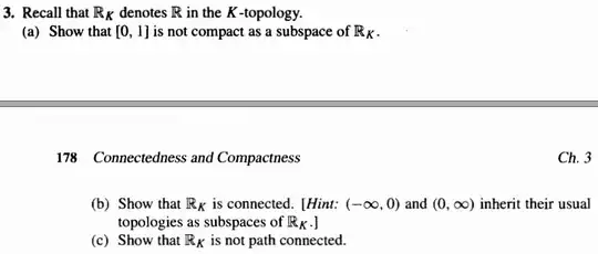

Topology by James Munkres Exer27.3c

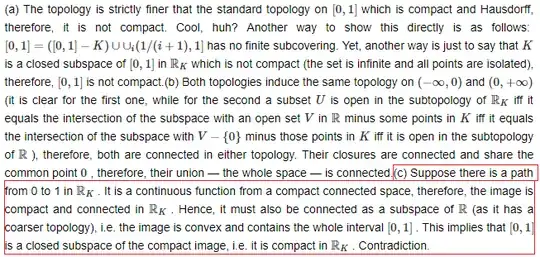

Here is dbfin's pf:
I am really confused because of all the $\mathbb R$ vs $\mathbb R_K$. I have found other proofs that I understand but would like to understand this one.
Is my understanding of this proof right? Also, please fill in gaps for where I am really not sure, mostly 4&7 below.
  1. Suppose on the contrary $\mathbb R_K$ is path connected. By definition, for any pair of points $x,y$ in $\mathbb R_K$, we can construct a path in $\mathbb R_K$ from $x$ to $y$, i.e. a continuous a function $f:[a,b] \to \mathbb R_K$ s.t. $f(a)=x$ and $f(b)=y$, where $[a,b]$ is a subspace of $\mathbb R$. Choose $x=0$ and $y=1$.
  2. $f([a,b])$ is compact and connected as a subspace of $\mathbb R_K$.
  • This is because $[a,b]$ is a compact and connected subspace of $\mathbb R$, and images of compact and connected subspaces of the domain of a continuous function are compact and connected subspaces of the range of the function.
  1. $f([a,b])$ is connected in $\mathbb R$.
  • This is because the topology of $\mathbb R_K$ is finer than the standard topology of $\mathbb R$.
  1. $f([a,b])$ is convex in $\mathbb R$.
  • I am really not sure why. I guess this is because for any set $A \subseteq \mathbb R$, $A$ is connected iff $A$ is an interval or ray iff $A$ is convex. I don't think all of these were proven at this point in the book. What has been proven so far I believe is that:
  • Any interval or ray in an ordered set X is convex in X and
  • Any interval or ray in $\mathbb R$ is connected.
  • I don't think it has been proven that the only connected sets of $\mathbb R$ are intervals or rays. I was actually expecting convex implies connected.
  1. $[0,1] \subseteq f([a,b]) \subseteq \mathbb R$
  • One might argue Intermediate Value Theorem (Thm 24.3), but here, this is because of (4), I guess.
  1. $[0,1]$ is a closed subspace of $f([a,b]) \subseteq \mathbb R$.
  • This is because compact subspaces of Hausdorff spaces are closed and subspaces of Hausdorff spaces are Hausdorff.
  1. $[0,1]$ is a compact subspace of $\mathbb R_K$.
  • 7.1. (6) implies that $[0,1]$ is a closed subspace of $f([a,b]) \subseteq \mathbb R_K$ because the topology of $\mathbb R_K$ is finer than the standard topology of $\mathbb R$. --> Is this right?!
  • 7.2. This implies that since $f([a,b])$ is a compact subspace of $\mathbb R_K$, we have that $[0,1]$ is a compact subspace of $f([a,b]) \subseteq \mathbb R_K$ because closed subsets of compact subspaces are compact subspaces.
  • 7.3. This implies (7), by Compact subspaces of compact subspaces are compact subsubspaces.

  1. A hint: Theorem 24.3. Yes, it is the intermediate value theorem stated for a function from a connected to an ordered set (btw, this is why you cannot use it for $\mathbb{R}_K$). Now think how to directly from this theorem obtain the statement that if a subset of $\mathbb{R}$ is connected then it is convex.
  2. Yes, (4) and NOT the IVT, see above. This is basically why I do (4). In essence, I prove the IVT for $\mathbb{R}_K$ using the fact that it is finer than the ordered $\mathbb{R}$.
  3. $[0,1]$ is the complement of the union of two open (in both topologies) intervals.
  4. 7.1. $[0,1]$ is closed in $\mathbb{R}_K$, see above. 7.2-7.3. Right, except you have a typo: closed subsets of compact spaces are compact.
