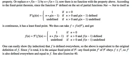

I was learning about fixed point theorem in the context of programming language semantics. In the notes they have the following excerpt:
Many recursive definitions in mathematics and computer science are given informally, but they are more subtle than they appear to be. The fixed-point theorem can be used to formally argue that such definitions are indeed correct. Consider, for example, the following common definition of the factorial: $$ f(n) = \left\{ \begin{array}{ll} 1 & \mbox{if } n = 0 \\ n * f(n-1) & \mbox{if } n > 0 \end{array} \right. $$ How can we know whether such a mathematical object, i.e., a function f satisfying the above property, actually exists and is unique, as tacitly assumed?
then it moves one to claim that somehow the fixed point theorem magically justifies this definition to be valid. Thats the part I don't understand. Why is that true?
I think they proceed to try to justify the fixed point theorem justifies it but I don't think I understand what in particular makes the fixed point theorem make this work. Any ideas?
Excerpt (from here) for more context (page 89):
$f(0)=0$ unambiguously exists because we said the symbol $f(0)$ means $1$ when $n$ is zero. $f(1)=f(0)*1=1*1$ because $f(0)$ exists, continue by induction... so $f(n)$ exists because its defined everywhere in its domain. I don't see what the fixed point theorem contributes to the discussion. I wish to understand of course.

17
Why is the fixed point theorem actually important here?
Well, let's think about why we believe that there is a function $f$ satisfying [recursive description of $!$]. It comes down to the following two (quite correct) beliefs:
  • We can use the recursive description of $!$ to "deduce" what the value of $!$ should be on each specific natural number.
  • We cannot use the recursive description of $!$ to deduce two contradictory things about $!$ (e.g. we can't use it to prove that $2!$ should be $7$).
With both claims in hand, we can then define $!$ by saying "$n!$ is the unique $m$ such that "$n!=m$" is implied by the recursive description." (In fact, only the second claim is needed to justify the existence of $!$ as a partial function.) But these claims need to be justified, and while in the case of the factorial function they are pretty obvious, $(i)$ the second claim is actually not as trivial to prove as one might hope and $(ii)$ certainly in general we want a theorem that lets us handle problems like these.
The fixed point theorem is basically a machine for getting around this issue: given a recursive description of a function, the fixed point theorem can (often) construct functions which actually satisfy that description in a precise, controlled way.
How we use it here (part $1$)
We can pass from the recursive description of the factorial function to a (perfectly good) definition of an operator on (partial) functions. The fixed point theorem shows that there is a fixed point, $f$, for this operator (once we've shown that this operator is in fact continuous); we then argue by induction that in fact this $f$ actually is the factorial function.
In detail:
From our self-referential "definition" of the factorial function, we can extract a perfectly good non-self-referential definition of an operator on partial functions $\mathcal{F}$: given a partial function $g:\mathbb{N}\rightarrow\mathbb{N}$, $\mathcal{F}(g)$ is the partial function given by
$$ \mathcal{F}(g):n\mapsto \left\{ \begin{array}{ll} 1 & \mbox{if } n = 0 \\ n * g(n-1) & \mbox{if } n > 0\mbox{ and } g(n-1)\downarrow\\ \uparrow & \mbox{if $n>0$ and $g(n-1)\uparrow$} \end{array} \right. $$
where "$\uparrow$" means "is undefined" and "$\downarrow$" means "is defined." (Note that I've written "$\mathcal{F}(g):n\mapsto...$" instead of "$\mathcal{F}(g)(n)=...$" for clarity, but there's no actual difference.) Intuitively, think of $\mathcal{F}$ as taking in a "partial computation" of $!$ - say, the first seventeen bits of the factorial function - and "going a bit further." The function we want is the "limit" of this process. This is exactly what the fixed point theorem says exists.
