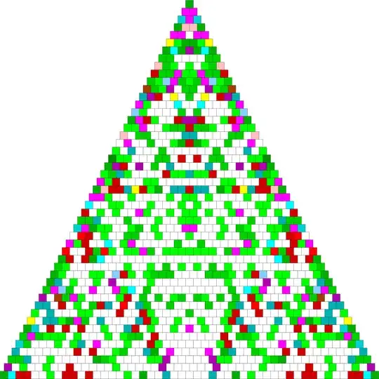

Arranging the tens in a Pascal's triangle, we find (*) the following structure (omitting the first ten on the edges of the triangle):
(*) I hope that my code is correct! It would be great if someone, more skilled than me, could confirm the emergence of such structure. In case you are interested in double-checking, please have a look to this post for details.
However, assuming that I did not mess up too much with the code, my conjecture is that
For very big tens, there cannot be colored squares other than on the outer diagonal of the triangle.
In other words, big primes $p$ must be in the form $p=10^{\binom{n}{k}}+1$, or $p=10^{\binom{n}{k}}+3$, or $p=10^{\binom{n}{k}}+7$, or $p=10^{\binom{n}{k}}+9$, and $k=1$. Clearly, a weaker version of such conjecture is that $k$ can oscillate among some little integer $2,3,4,5\ldots$ (which ones?).
This is probably an obvious result for the experts (I apologize, in case), nevertheless I would be glad to understand the connections between this approach and others, and also to know if there is some technique to attack such problem.
Sorry for possible naivety, and thank you very much for your comments and suggestions!

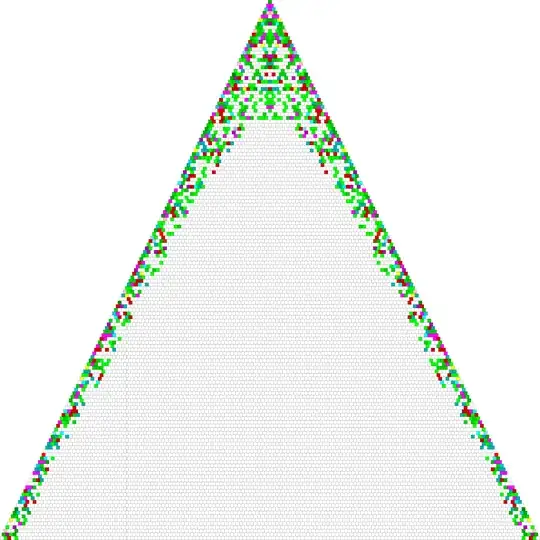

EDIT: The conjecture was based on the assumption that the plot of the triangle was correct. But, as Ross has shown, that was not the case. An improved version of the code producing that plot, in fact, results in this picture:

  • The top square looks to be one of the blues. I don't understand what you mean be omitting the first ten on the edges. Should the top square be ${5 \choose 2}={5\choose 3}=10?$ Why are the next two purple? I don't understand how you came up with your picture. Does the big white area in the middle claim that if I take a binomial coefficient in that region and replace the ones digit with $1,3,7,9$ I will not get a prime? It would be helpful to have only the top ten rows in a larger picture with the coefficients shown in colored squares. – Ross Millikan Aug 28 '18 at 19:08

  • @RossMillikan I omit the first ten $\binom{1}{0}$ on the edges because they do not add much to the picture. The top blue is green, the second ten. Please, have a look here https://math.stackexchange.com/q/289614/559615 for more details. Yes, the big area should not contain primes, if my code is correct. –  Aug 28 '18 at 19:13

  • I tried to follow your link, but it is to an unrelated question. Is the top one green because it comes from ${6 \choose 3}=20$ and the primes in $[20,29]$ are $23,29$? Then the two purples below come from ${7 \choose 3,4}=35$ and $31,37$ are prime? Which row is the last one has colored squares going all the way across? I strongly suspect your algorithm is failing when the numbers get too large. – Ross Millikan Aug 28 '18 at 19:19
  • @RossMillikan Sorry Ross for the awful picture. If you take this picture representing the position of the squares https://upload.wikimedia.org/wikipedia/commons/thumb/9/95/PascalsTriangleCoefficient.svg/220px-PascalsTriangleCoefficient.svg.png I just removed the outer edge. Give me some minutes, and I tell you the row. –  Aug 28 '18 at 19:22
  • @RossMillikan It is the ten 34 (i.e. row 34 in Pascal's Triangle). –  Aug 28 '18 at 19:27
  • (+1) Love your posts. How do you come up with these things? – TheSimpliFire Aug 28 '18 at 19:28
  • @TheSimpliFire Thanks! It is just the natural development from this idea https://math.stackexchange.com/questions/2886024/a-conjecture-involving-prime-numbers-and-circles –  Aug 28 '18 at 19:30
  • But ${36 \choose 13}=1251677700,$ the first one I tried, and $1251677701$ is prime. That square should not be white – Ross Millikan Aug 28 '18 at 19:30
  • @RossMillikan 36 gives you the position in the triangle, but it represents a ten, therefore we should check if $1251677700\cdot 10$+1, +3, +7 or +9 are prime. However, now I check again. –  Aug 28 '18 at 19:35
  • So your claim is that if I take any entry $N$ in the middle of Pascal's triangle then $10N+1, 10N+3, 10N+7,$ and $10N+9$ are all prime? It would have helped to make that clear. All the talk about $10$s does not do so. – Ross Millikan Aug 28 '18 at 19:41
  • ${37 \choose 13}=3562467300$ and $35624673001$ is prime – Ross Millikan Aug 28 '18 at 19:43
  • I checked the code many times, but maybe there is a mistake. I am checking it again. –  Aug 28 '18 at 19:45
The large white area in the middle claims that if $N$ is any number in that area of the triangle then none of $10N+1, 10N+3, 10N+7, 10N+9$ are prime. The claim is false as ${37 \choose 13}=3562467300$ and $35624673001$ is prime.

  • You just need to compute $n \choose k$, which you can just do by summing the two entries above, then check the four numbers for being prime. Clearly one of these steps is not working properly. I suspect it is your primality test. Maybe you are getting overflow of the integers you are using, because that region of the triangle has reasonably large numbers in it. – Ross Millikan Aug 28 '18 at 20:12
  • Yes, This is the problem. Also, do you know a good repository for primes? Thanks, Ross! I should delete this post, but I can't. –  Aug 28 '18 at 20:15
