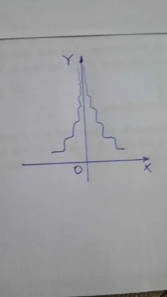

    The claim is not true in general; one counterexample is $f(x)=1/x^2+\sin(1/x^3)$, with $a=0$. You can weaken it to $\limsup_{x\to a}[f'(x)/f(x)]=+\infty$, or you can assume monotonicity of $f$. – user254433 Jul 29 '18 at 08:49
8
This is actually wrong. For this function: Graph there are values of x arbitrarily close to $0$ such that $\frac{f'(x)}{f(x)} = 0$. If you want an explicit expression, take $f(x) = \frac1x + sin\Big(\frac1x\Big)$
Eulerrr
  • 309
The most you can show is that $f'/f$ is unbounded in any neighborhood of $a$.
