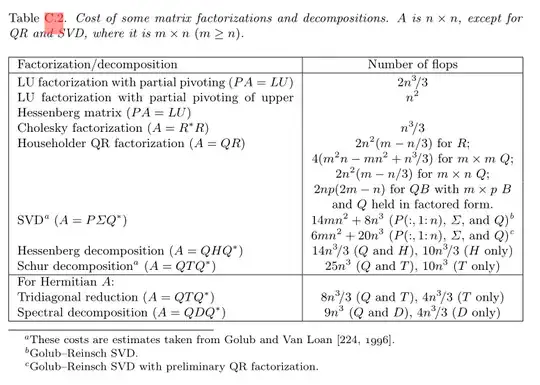

10
Nick Higham's book "Functions of Matrices Theory and Computation" has a nice summary of the computation costs that he scraped from Golub and van Loan's "Matrix Computations" book that summarizes the constant costs. Do note, this all makes assumptions on how we want to value different operations, which are not all the same:
Cost of Factorizations
Anyway, it's easier to see why certain factorizations are faster than others.
