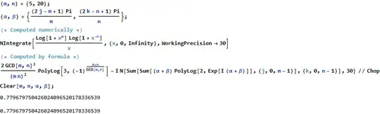

The following code tests the above formula.
Numerical computation
