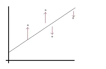

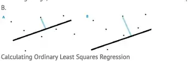

I have always been confused about whether the approximate solution to $Ax=b$ is equivalent to minimizing the average distance of all of the $b$ vectors to $Ax$, or whether it is minimizing the distance projected along the $b$ axis?
(where $A$ is full rank and skinny and the system is overdetermined).
Consider these two pictures: minimizing the distance projected along the $b$ axis from http://www.statisticshowto.com/least-squares-regression-line/
and another figure on the same page:
projection onto the line $Ax$ also from from http://www.statisticshowto.com/least-squares-regression-line/.
Notice these are two figures on the same page! I do not understand how these are both being minimized at the same time. can someone please explain? thanks.

The least squares value is the $x$ that minimizes $(Ax-b)^2.$ However, least squares is more often thought of as a curve fitting method where you want to fit a line to the points $(x_1,y_1),$ $\ldots,(x_n,y_n) $ and you want a best fit line. In this case we take $$ A = \pmatrix{1& x_1\\ 1& x_2\\\vdots& \vdots\\ 1 & x_n}$$ and $$b = \pmatrix{y_1\\\vdots \\y_n}$$ and parametrize $x$ as $x=\pmatrix{a\\b}$ and then when we minimize $(b-Ax)^2,$ we get a fit line $y_i\approx bx_i + a.$ The picture of the fit line matches your first diagram above. And the quantity you have minimized is the sum of the squares of the quantities depicted.

However, when we look at it as an approximate solution to an overdetermined system of equations, you can view it as finding an orthogonal projection onto the column space of $A$ that minimizes the Euclidean distance in $n$-dimensional space between the point $b$ and the point $Ax$ that it's projected to.
  • At first you say "The pictures of the fit line matches your [my] first diagram above", but this doesn't seem to be consistent with what you say later about "view it as finding an orthogonal projection onto the column space of A" (that seems to align with my second figure more closely). – makansij Jul 01 '18 at 05:05
    @Candic3 Viewing the link in context the second picture just seems out and out wrong. In the view as an orthogonal projection (where these figures would be schematic representations of things in high-dimensional spaces) the plane you're projecting on is a fixed thing (it is the column space of $A$)... not something you move around to minimize some distance. The distance that is being minimized is that between the point and the point on the plane it is being projected onto. In other words we're choosing the projection that moves points orthogonally rather than any other direction. – spaceisdarkgreen Jul 01 '18 at 05:11
    @Candic3 When we're viewing this as a trend-line fitting procedure as I outlined above, it's best for one's sanity to write it as $y =X\beta$ rather than $b=Ax$ where $X$ is a $n\times 2$ matrix as I wrote down above with the first column all ones and $\beta$ is $2\times 1$ where the first component is an 'intercept' and the second is a \slope' of the regression line. Then we view $X\beta$ as an estimate of $y$ by a trend line and the components of $y-X\beta$ are the errors drawn on the first diagram. So minimizing $(y-X\beta)^2$ over $\beta$ is minimizing the sum of squares of those errors. – spaceisdarkgreen Jul 01 '18 at 05:22
  • For what you're saying, the first image (with red lines) seems more correct to me. we are minimizingthe residuals, which are the differences between our prediction of y and the true value of y. Howev,er i've seen other authoritative sources that use figures similar to figure 2 (e.g. Stephen Boyd at Atanford: https://see.stanford.edu/materials/lsoeldsee263/05-ls.pdf on slide 3). Is there no validity to these slides? Can you think of an example where minimizing according to the first image will not obtain the same minimizer as the second image? – makansij Jul 01 '18 at 05:30
    @Candic3 Choosing $\beta$ to minimize the sum of squared residuals between $y_i$ and $(X\beta)_i = bx_i+a$ (where the residuals are depicted in your first diagram) and choosing $\beta$ so that $X\beta$ is the orthogonal projection of $y\in \mathbb R^n$ onto the column space of $X$ (as depicted in the slides you sent) are the exact same thing. These diagrams refer to superficially very different concepts that happen to be different depictions of the same thing. – spaceisdarkgreen Jul 01 '18 at 05:42
    @Candic3 If it helps, orthogonal projection is a much more general thing than trend-line fitting by least squares. Trend-line fitting is orthogonal projection applied to the situation $y = X\beta$ where $X$ takes that form with the first column ones and the second column the $x$ data and $y$ is the y data. – spaceisdarkgreen Jul 01 '18 at 05:58

In the first picture, we want the line of best fit. We want to solve $A\bf{x}=b$ in a way that makes $ \| A\bf{x}-b\|$ minimum. We cannot have $A\bf{x}=\bf{b}$, but will find $\bf{\overline{b}}$ such that $A\bf{x}=\bf{\overline{b}}\in$ $R(A)$ (orhogonal proj of $\bf{b} $ onto $R (A) $), with $\bf{x}$ $=(a,b)$ say, and the line of best fit $y=ax+b$ (A as in one of the other answers above).
So in the actual data plot we have the point $(x_i,y_i)$ and its corresponding 'best fit' point $(x_i,ax_i+b)$. The distance between the actual and 'estimated' point is the distance between these two points and is indicated in the graph by the red arrow (measured on the $y$-axis if you wish). The sum of these terms (each squared) is also said to be sum of squared errors of this 'approximation', and it has been minimised by using the 'least squares' method.

  • Okay, so from what I understand of your answer, we are minimizing what is shown in the first figure (with the red lines) - NOT the second figure. So, is the 2nd figure relevant to least squares at all? Or does it not matter whether we optimize for the minimal orthogonal distance (figure two with blue lines) versus the minimal residual distance (figure 1 with red lines)? – makansij Jul 01 '18 at 05:15
    @Candic3 I would not give the second picture much thought. It seems misleading (it is not clear what 'distance' one is supposed to think of here) and it is not properly labeled or referenced. – AnyAD Jul 01 '18 at 05:29
  • Check out https://see.stanford.edu/materials/lsoeldsee263/05-ls.pdf on slide 3. Are you telling me that's wrong? – makansij Jul 01 '18 at 05:30
    @Candic3 No, that is not what I am telling you at all. What is on that slide is what I have described in my answer above and it is correct. You can take that picture, then, as a schematic representation of the projection of vector $b$ onto $R(A)$, which as I have already said, is an orthogonal projection. – AnyAD Jul 01 '18 at 05:37
