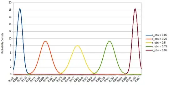

I recently asked myself identically this question. The conclusion I came to is that the variance is a function of the mean because the mean is on a bounded interval. That is, obviously/by definition, half of the outcomes have to be above the mean. When the mean approaches 1 (or likewise, as it approaches 0), it becomes harder to have a large variance, because the outcomes that would have been required to "average out" the lower valued outcomes simply cannot exist because of the interval on which the values are defined. Graphically, these are the distributions you get at different means (here the "means" are the 'r_obs' values defined in the legend). For the blue one (u = 0.05) to have a larger variance, since it has to stretch out symmetrically because of the particular model in question, you can see it would have to stretch past 0 to the left, which is not allowed.
David Doria
