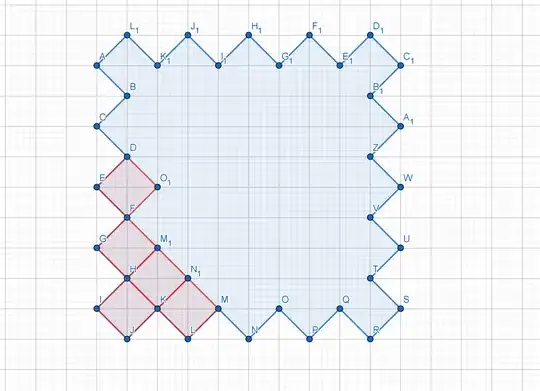

However, maybe you can visualize the polygon like this: enter image description here
All the internal angles are either $90^\circ$ or $270^\circ$.

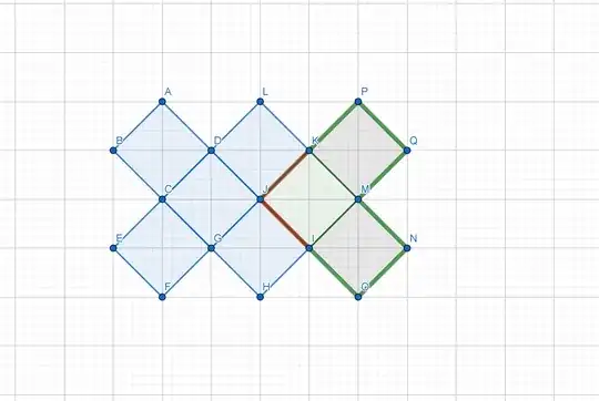

Another way of visualizing: enter image description here
Observe that you have a $12$-sided polygon here, comprised of $5$ squares. The next acceptable polygon would be this: enter image description here Notice that $2$ sides are lost and $6$ more sides are added, thus we have a $16$-sided polygon. Notice too that there are $3$ more additional squares.
Therefore, for a polygon in this form, the number sides can be expressed as: $$12+4x \Rightarrow 12+4x=2016\iff x=501$$ Using $x$, the number of squares that compose this polygon will be: $$5+3x\Rightarrow 12+3\cdot501=1508$$ Therefore, we have an even number of squares therefore the area is an even integer.

    This can get one specific polygon, but we are asked for a proof for all polygons meeting the requirements. – Ross Millikan Jun 19 '18 at 03:52
    @RossMillikan that's why it's not a complete proof, but only to fuel OP's intuition. – John Glenn Jun 19 '18 at 03:53
