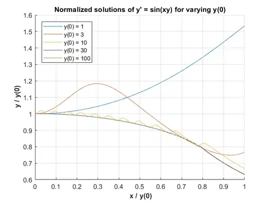

For large enough values of $y_0$, the solutions to this equation appear to converge onto a specific shape under the appropriate normalized scale—dividing both $x$ and $y$ by $y_0$.
Can any statements be made about the form of the function corresponding to this shape/normalized solution?
See below for a graph of numerically computed solutions to this ODE that demonstrate this phenomenon.

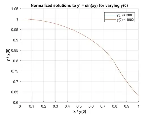

I've plotted the solutions for even larger $y_0$ below so that the shape these solutions are converging to can be viewed more clearly. Only one line is visible as both solutions are virtually the same under the normalized scaling.

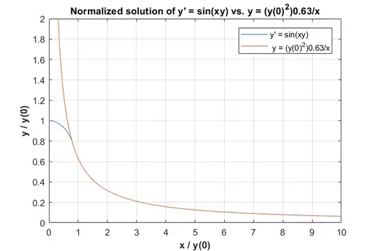

Intrigued by this, I found numerically that for large $y_0$, the solution past the $y = x$ point (about 0.7929) matches $y = 0.63 y_0^2 / x$ essentially perfectly. See below for a comparison plot.

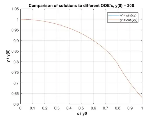

It seems as if the solution of $y' = \cos(xy),\ y(0) = y_0$ converges onto this unknown function as well for large $y_0$. See the graph below for numerical evidence; only one line is visible as both solutions are essentially the same.
Could the asymptotic form of these solutions have some exponential component in the region where $y > x$?
