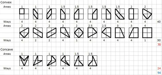

Consider $2\times 2$. Consider all possible quadrilateral shapes of specific areas and count the number of ways (by rotations and reflections). If I did not miss out any shape, here is what I got: enter image description here

  • Two minor mistakes. 8th diagram in the first line has area 1.5 in stead of 2. The 2nd and 3rd diagram in the second line only have two ways, this results then in a total of 94 different simple quadrilaterals in a $3\times3$ grid. – Ronald Blaak Apr 29 '18 at 16:39
  • RonaldBlaak, good catch, updated, thank you – farruhota Apr 29 '18 at 16:55
  • here it is given a combinatorial method: http://mathforum.org/library/drmath/view/54269.html – farruhota Apr 29 '18 at 17:00
