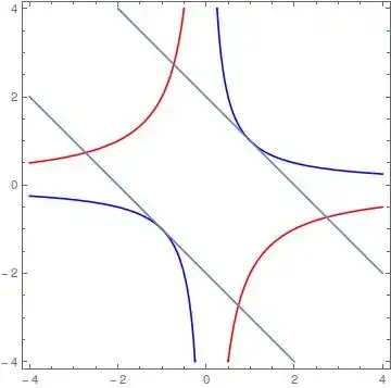

$$ x^2y^2+xy-2 = 0 $$
Calling $z = xy \Rightarrow z^2+z-2 = (z+2)(z-1) = (xy+2)(xy-1) = 0 \Rightarrow\left\{ \begin{array}{rcl} xy +2 & = & 0\\ xy - 1 & = & 0 \end{array}\right.$
Attached a plot of $(xy+2)(xy-1) = 0$ In red $xy+2=0$ and in blue $xy-1 = 0$
Hence the tangency should be determined over $xy-1=0$ with two solutions for $x = \pm 1$
