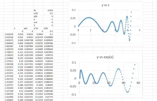

ran some numerical integration on this ... looks like the "period" of oscillations is decreasing exponentially while the envelope amplitude is exponentially increasing. enter image description here
