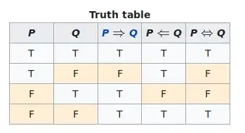

In a quick research about logic I found that $P \iff Q$ has the following truth table:

I understand that this proof requires at least two steps:
- $E_1 \implies E_2$
- $\neg E_1 \implies \neg E_2$
