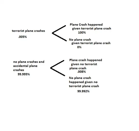

I think Nate did a bad job explaining his thinking. For me Bayes is confusing, so I try to make it very clear what my assumptions are to explain the probabilities.
In his example, his initial probability (.005%) describes the likely-hood of terrorist attacks in Manhattan via plane attack into skyscrapers prior to 9/11. This means 99.995% of the time is not a terrorist attacks in Manhattan via plane attack, which is NOT just accidental plane crashes. It would be everything including normal days with no crashes and accidental plane crashes.
He then uses plane crashes as a test on these two events. He doesn't explicitly say this, but his test is to assume every plane crash is a terrorist attack. Given there is a terrorist attack to hit a Manhattan building with a plane, we are 100% that our test, a plane crash, will tell us so.
On the flip side, the 99.995% side, what are the chances our test, plane crashes are terrorist attacks, accurately predicts no terrorist attack? Well, accidental plane crashes into Manhattan buildings have shown a historical precedence of .008% likely-hood to occur. This number is a false positive for our test, the chance a plane crash incorrectly predicts there was a terrorist attack. This can also be understood as the chance our test will say it was a terrorist attack given it was a normal day OR an accidental plane crash .
I made a diagram:
Chart Using Bayes, you can establish what is the likely-hood there was a terrorist attack in Manahattan via plane crash given that a plane crashed, using your plane crash test.
You can run this model to get the updated value of an accidental plane crash AND normal days given a plane crash as you've done as well (61.5%). As you may have noticed, 100% - 38.5% = 61.5%. Essentially, this is the OPPOSITE of Nate's assumption, and the number isn't going up, its going down from 99.995%. This model is agnostic to whether the plane crash was a terrorist attack or an accident, as some of the above answers are confused about. This model already takes into the account the likely-hood of accidents and terrorist attacks with its plane crash test.
61.5% does NOT fit into the false positive plane crash test slot as that would change your model. 61.5% is the likely-hood that there was an accidental plane crash given there was a plane crash, NOT the probability of a plane crash given that it's not a terrorist attack via plane crash. You don't change the .008% the same way Nate didn't change the 100% when updating his formula the second round of Bayes because the equation already takes it into account. The second round of Bayes assumes you have no new information on whether the plane crash was a terrorist attack or an accident.
I believe your main concern is Nate makes an assumption that the first plane was a terrorist attack for the second plane attack. He does not. This Bayes inference simply tells us the likely-hood of plane crashes being terrorists attacks given that there were plane crashes. The only "assumption" Nate made was there were two plane crashes. Given two plane crashes using this model, your likely hood of it being an accidental plane crash AND a normal day becomes .00128%, it does not go up as you've mentioned and it does not describe JUST accidental plane crashes but both accidental plane crashes AND normal days.
Hope this helps!
