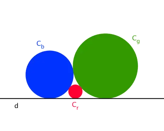

I found in a book of Sangakus the following problem.
Three Circles
Let $R_b$, $R_g$ and $R_r$ the radiuses of the blue, green and red circles $C_b$, $C_g$ and $C_r$.
Prove that $$\frac{1}{\sqrt{R_r}}=\frac{1}{\sqrt{R_b}}+\frac{1}{\sqrt{R_g}}\,.\quad (1)$$ And this I can do. But then
I would like to draw the figure myself with only a ruler and a compass.
I know it is possible as I can construct inverses, sums and square roots with only a ruler and a compass, but when I tried to draw the figure with a "simple" or "natural" construction, I failed.
Does someone have an idea of how to draw it "naturally"?

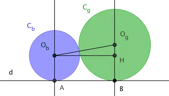

Answer to a comment of Amzoti: To prove Relation (1) I first prove the relation: $$AB^2=4R_gR_b\quad (2)$$ Two Circles Relation (2) is a consequence of Pythagoras' theorem in the triangle $O_bO_gH$: $$AB^2+(R_g-R_b)^2=(R_b+R_g)^2\,.$$ (It was the previous Sengaku in the book.)
We thus get the relations $$ \begin{align} AB^2 & =4R_gR_b\quad (2) \\ AC^2 & =4R_gR_r\quad (3) \\ BC^2 & =4R_bR_r\quad (4) \\ \end{align} $$ where $A$, $B$, $C$ are the orthogonal projections of the centers of the circles $C_b$, $C_g$ and $C_r$ on the line $d$. The relation $AB^2=AC^2+BC^2+2AC.BC$ then yields, using Relations (2) to (4), $$4R_gR_b=4R_gR_r+4R_bR_r+8\sqrt{R_bR_g}R_r$$ Divided by $4R_rR_gR_b$ this equation is $$\frac{1}{R_r}=\Big(\frac{\sqrt{R_g}+\sqrt{R_b}}{\sqrt{R_bR_g}}\Big)^2$$ which is in fact Relation (1) squared.

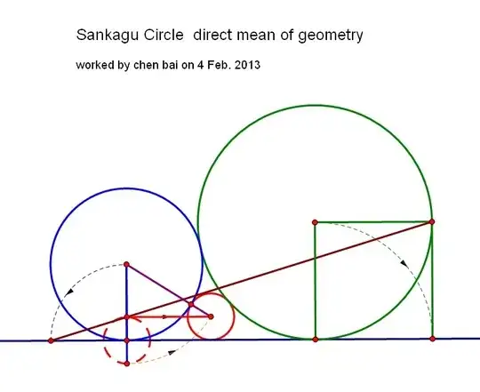

I found another straightforward method which can be perfectly show the meaning!
chenbai
  • 7,681
  • Are you sure this construction is right? I tried to do it but it did not seem to give the right circle. – Sebastien B Feb 04 '13 at 07:53
  • yes, I review it again and 100% right. it can be easily proof the radius is satisfy the formula. – chenbai Feb 04 '13 at 10:12
  • $DC=2\sqrt{r1*r2}. $ – chenbai Feb 04 '13 at 10:20
  • I checked it again, and it works indeed. Marvelous. How did you come to this construction? – Sebastien B Feb 04 '13 at 10:38
  • it is my 3rd version. the 2nd version post first which I think it is fine. then I check it again when I review my comments, I realize the DC is what we need. then rest thing is simple. BTW, you have to convert r formula in normal way, ie, r=XXXX, then you will find the a factor $ r1+r2+2\sqrt{r1*r2}$. it take me sometime to find this factor. Anyway, I am very happy to find this solution and thank you for the question. – chenbai Feb 04 '13 at 11:54
  • @chenbai Fine solution ! I wrote a solution (Sangaku Alain Matthes) but more complicated (long) that yours – Altermundus Aug 15 '19 at 08:38

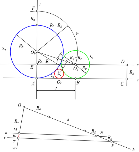

We'll solve the following problem:
Given, a straight line $r$, a point $A$ such that $A \in r$ and the radii $R_b$ and $R_g$, construct three circles $\lambda_b$,$\lambda_g$ and $\lambda_r$, such that they are tangent to each other and to $r$, and $R_r \leq min(R_b, R_g)$.($R_b$, $R_g$, and $R_r$ are the radii of $\lambda_b$,$\lambda_g$ and $\lambda_r$ respectively).
See the figure below: SangakuConst
  1. Draw a straight line $t$ such that $A \in t$ and $ t \perp r$.
  2. Mark $O_b$ such that $O_b \in t$ and $O_bA = R_b$.
  3. Draw $\lambda_b$.
  4. Draw $s$ such that $s \parallel r$ and $d(s,r)=R_g$.
  5. Draw an arc $\mu$ centered at $O_b$ and radius $R_b + R_g$ such that $\mu$ intesects $s$. The intersection point is $O_g$.
  6. Draw $\lambda_g$.
  7. Find out $R_r$. (Auxiliary construction).
  8. Find out $O_r$. ($O_r$ is the intersection point of two arcs: one of them has $O_b$ as center and $R_b + R_r$ as radius and the other one has $O_g$ as center and $R_g + R_r$ as radius).
  9. Draw $\lambda_r$.
Let $d=d(A, B)$ , where $\{B\}= r \cap \lambda_g$.
  1. From a point $Q$ draw two arbitrary rays $w$ and $h$.
  2. Mark a point $N$ such that $d(N,Q) = R_b + d + R_g$ and $N \in h$.
  3. Mark a point $M$ such that $d(M,Q) = R_b$ and $M \in w$.
  4. Draw a straight line $u$ such that $u$ passes through $M$ and $N$.
  5. Mark a point $P$ such that $d(P,Q) = R_b + d + R_g + R_g $ and $P \in h$.
  6. Draw a straight line $v$ such that $v \parallel u$ and $v$ passes through $P$.
  7. $R_r = d(M,T)$ where $\{T \}= v \cap u$.

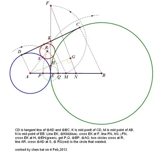

enter image description here]![enter image description here
I think my method is the one you may want. it is nature.
it is not difficult to proof. just care $KE=\sqrt{r1*r2}$ and KM=MB
chenbai
