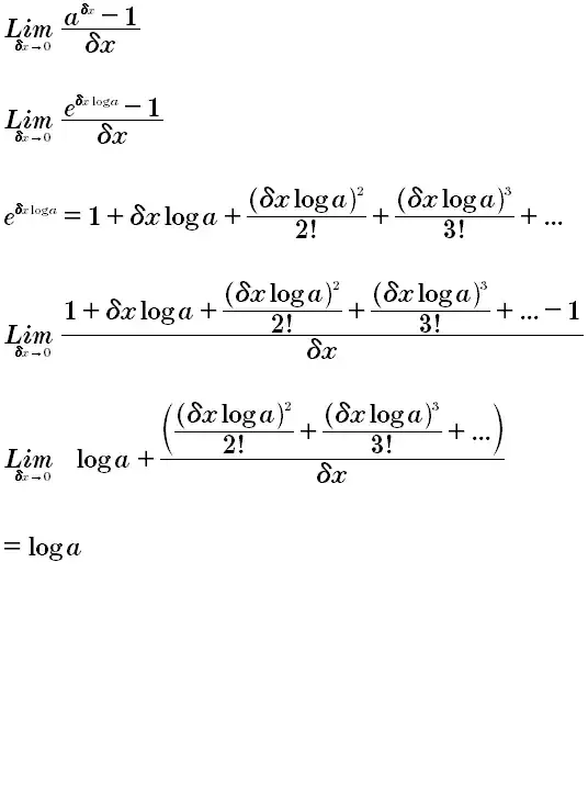

enter image description here $$\phantom{extra characters. Please convert the image above to Latex.}$$
