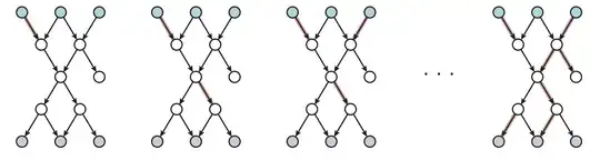

I've sketched out such a procedure for a small graph below. The top (green) nodes are the nodes $\mathcal{N}_s$ whereas the bottom (purple) nodes are the nodes $\mathcal{N}_t$. At each step of the procedure a single edge is sampled at random (denoted by the red edges). A check is done to see if it is a path that satisfies the condition, if not, sample a new edge (without replacement) and check again. Repeat until we find a path. If the addition of a single edge results in multiple paths, pick one at random. We add this path to our set of sampled paths, call it $\mathcal{\bar P}$, and repeat the process.

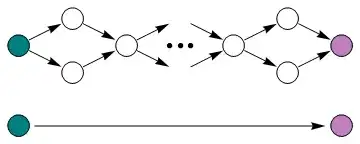

Here's an example where the output of this procedure is far from uniform:
biased paths
In the top half of the graph, we have $n$ "diamonds", each consisting of $4$ edges. There are $2^n$ paths from left to right in the top half of the graph: for each diamond, we can choose one of two possible routes to take. There is also one path in the bottom half of the graph consisting of a single edge.
The bottom path has at least a $\frac1{4n+1}$ chance of being chosen because that is the chance we will choose its only edge in the very first step. (And actually, it gets at least $n$ chances to be chosen before any other path can be constructed, so it is the first path to be found a constant fraction of the time.) But we want it to have a $\frac1{2^n+1}$ chance of being chosen. So, for large $n$, its probability of being chosen will be exponentially higher than the chance we choose any of the other paths.
We can use rejection sampling to produce an algorithm that will work for any graph with a little bit of finetuning. But its performance depends heavily on properties of the graph.
Begin with a method we know to be biased. Choose a random starting node in $\mathcal N_s$. Then repeatedly choose a random edge out of the last vertex visited, until we arrive at a vertex in $\mathcal N_t$. This produces a path. (This method gets stuck if it arrives at a vertex not in $\mathcal N_t$ with out-degree $0$, so we should pre-process the graph by iteratively pruning such vertices, which cannot contribute to paths anyway.)
Even though this is biased, we know exactly how likely it is that any given path will be chosen: a path on vertices $v_0, v_1, v_2, \dots, v_k$ with $v_0 \in \mathcal N_s$ and $v_k \in \mathcal N_t$ is chosen with probability $$ p = \frac1{|\mathcal N_s|} \cdot \frac1{\deg^+(v_0)} \cdot \frac1{\deg^+(v_1)} \cdots \frac1{\deg^+(v_{k-1})}. $$ We can also put some lower bound $p_{\text{min}}$ on the probability of choosing the least likely path. A trivial lower bound is $\frac1{|\mathcal N_s|}\prod_{v \in \mathcal N} \frac1{\deg^+(v)}$, but we can do better if we can put an upper bound on the length of a path or on the number of high-degree vertices each path visits. (In the example I drew above, it's easy to see that $p_{\text{min}} = \frac1{2^{n+1}}$.)
So the final step in the algorithm is that once we generate a path with the biased method, we actually return it as our output only with probability $\frac{p_{\text{min}}}{p}$, and start over otherwise. As a result, each path has the same probability of $p \cdot \frac{p_{\text{min}}}{p} = p_{\text{min}}$ of being returned at each iteration, and the sampling is uniform.
The better the lower bound $p_{\text{min}}$, the faster the algorithm will work. The speed is also affected by the distribution: if there are a few very unlikely paths that achieve the lower bound, then they will slow down the algorithm for all the other paths. But if a constant fraction of paths have a probability close to $p_{\text{min}}$ of being returned, then this algorithm will usually require only a few trials.
