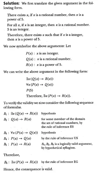

My professor asked us to assess the validity of the following argument:
Some rational numbers are powers of 5. All integers are rational. Therefore, some integers are powers of 5.
My professor went back and forth on the validity of the argument after I questioned his logic. Finally, he asserted that the argument is invalid and he gave this argument:
Now let us abstract this argument, letting R represent the set of rational numbers, P the set of powers of five, and G the set of integers. Then the premises and conclusion become: 1) Some element of R belongs to P. 2) All elements of G belong to R. Conclusion: Some element of G belongs to P.
As a model of this argument, let R = { a, b, c }; P = { c }; and G = { a, b }. Are the premises true? 1) Some element of R belongs to P. 2) All elements of G belong to R. Does the conclusion now follow: Some element of G belongs to P?
I've spoken to another professor who says the argument is valid and I've seen different answers to this problem including this one:
from some textbook - name unknown
Link here: see exercise 6
So I ask, what is the truth?

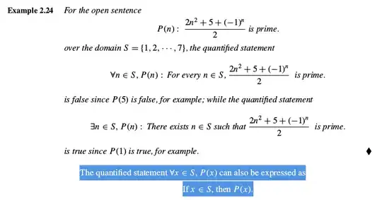

In addition, for any open sentence P(x), is $$\exists x \in \mathbb{Q} P(x)$$ not equivalent to, $$\exists x (x \in \mathbb{Q} \Rightarrow P(x))$$ and if these are not equivalent, then why does the author, in the example below, rephrase the following quantified statement as an implication? enter image description here

  • They are arguing that the conclusion follows from the premises? But it clearly does not. Consider this argument.... $#1:$ Some rationals are between $\frac 12$ and $\frac 34$. $#2:$ All integers are rationals. Therefore, some integers are between $\frac 12$ and $\frac 34$, How does this differ logically from what you were shown? – lulu Feb 13 '18 at 00:13
  • It's confusing because of course we know that some integers, such as $5$, are powers of $5$. So the conclusion is true in the abstract. But as a matter of pure logic, I don't understand the reasoning shown here. – lulu Feb 13 '18 at 00:14

  • Well, unless I am missing something the argument seems entirely invalid. It's like saying "some good meals are vegetarian. Every steak dinner is a good meal. Therefore some steak dinners are vegetarian." – lulu Feb 13 '18 at 00:20
  • Regarding my very last question. My professor asserts that they are not equivalent but then I have this other textbook saying that they are equivalent hmmm so that adds to my confusion – rachelhoward Feb 13 '18 at 00:20
  • I don't understand your notation. I thought $Q(x)$ was the statement "$x$ is a rational number". – lulu Feb 13 '18 at 00:22

  • Regarding the embedded image, "There exists $x$ such that if $x$ is an integer, then $x$ is a power of $5$" is not the same as "There exists $x$ such that $x$ is an integer and $x$ is a power of $5$". – stewbasic Feb 13 '18 at 00:24
  • That is, I believe the image presents a valid proof of $\exists x(P(x)\rightarrow R(x))$ but what you want to prove is $\exists x(P(x)\wedge R(x))$. – stewbasic Feb 13 '18 at 00:25
The argument is invalid. Here is a refutation by logical analogy:
Some coins are dimes
All nickels are coins
Therefore, some nickels are dimes
The argument based on formal logic notation fails, since it uses the wrong symbolizations. For example, some rational numbers are powers of five needs to be symbolized as:
$$\exists x (Q(x) \land R(x))$$
and not as:
$$\exists x (Q(x) \rightarrow R(x))$$
So ... either the text was asking you to find the error in the 'Solution' ... or the text provided a horribly mistaken Solution! Given how everything else labeled 'Solution' seems to be treated as the actual answerk to the exercises, I fear it's the latter .. what text is this?!

  • @rhoward The universally quantified statement can indeed be written as a conditional, but not the existential. That is: $\forall x \in S: P(x)$ can indeed be written as $\forall x (x \in S \rightarrow P(x))$, but $\exists x \in S : P(x)$ rewrites as $\exists x (x \in S \land P(x))$ – Bram28 Feb 13 '18 at 02:57
