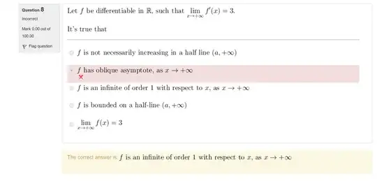

What I did was to see that the function is behaving as a straight line with gradient $3$ at infinity which implies that the function has an oblique asymptote as $x \to \infty$ but my testing portal says the answer is wrong and that instead, the function is infinite of order $1$ with respect to $x$. I think both of these are correct otherwise I must be confusing terminologies here

what does it mean "to be an infinite of order 1 at infinity" ? Is it $\mathcal O(x)$ ? – idm Feb 10 '18 at 10:22
i think it means that the order of the principal part at infinity is 1 – M.Hamza Ali Feb 10 '18 at 10:24
2Consider $f(x)=3 x+ \log(x)$ which has $f'(x) = 3 +\frac1x \to 3$. Try to find the oblique asymptote – Henry Feb 10 '18 at 10:26

Note that in order to have a oblique asymptotes
- $y=mx+n$ with $m,n\in \mathbb{R}$.
with
$$m=\lim_{x\rightarrow+\infty}\frac{f(x)}{x}$$
and
$$n=\lim_{x\rightarrow+\infty} (f(x)-mx)$$
both limit must exist.
Note that since the function is evantually strictly increasing $f(x)\to +\infty$ thus
$$\lim_{x\rightarrow+\infty}\frac{f(x)}{x}= \lim_{x\rightarrow+\infty}f'(x)=3$$
thus $f(x)=\mathcal O(x)$.

if the function is behaving as a straight line does it mean that c also exists? – M.Hamza Ali Feb 10 '18 at 10:26
@M.HamzaAli It is not a sufficient condition, think to the example given in the commentd $f(x)=3x+log x$ – user Feb 10 '18 at 10:39
The existence of an oblique asymptote is too strong. The derivative may approach 3 while the graph is not necessarily asymptotic to the line y=3x+b. It may oscillate and cross that line infinitely many times.
- 69,891
An example of a function on $\mathbb R$ with $\lim_{x\to\infty} f'(x) = 0$ but does not have a horizontal asymptote is $\log(1+x^2)$. If you prefer $f'(x) = 3$, try $$f(x) = 3x+\log(1+x^2).$$
