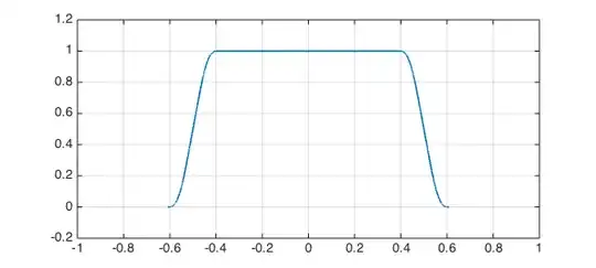

This example is not smooth, and indeed if $f\in C^\infty_c$ then $\hat{f}\in L^1$; see Netchaiev's answer. However, you cannot hope for an inequality such as $$\tag{FALSE} \|\hat{f}\|_1\le C \|f\|_\infty, \quad \forall f\in C^\infty_c$$ with $C>0$ independent of $f$. If this were true, you could take a sequence $f_n$ of smooth compactly supported functions approximating the previous example $f$ and the inequality $\|\hat{f}_n\|_1\le C\|f_n\|_\infty$ would extend to $\infty=\|\hat{f}\|_1\le C\|f\|_\infty=1.$
P. S. Please note that the last approximation process has to be done with some care, because $C^\infty_c$ is not dense in $L^\infty $. It suffices to take a sequence of smooth compactly supported functions approximating $f$ with the property $\|f_n\|_\infty \le 1$, like the ones in this picture: Found on the web
