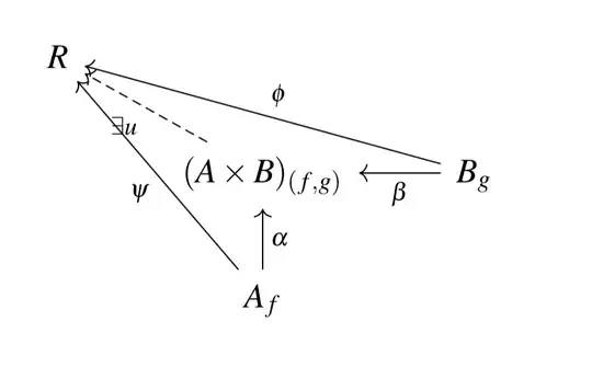

As for my naive comment to claim that I can check the universal property of coproduct. enter image description here
where $$ \alpha:\frac{a}{f^n}\mapsto \frac{(a,g^n)}{(f,g)^n} $$ $$ \beta:\frac{b}{g^m}\mapsto \frac{(f^m,b)}{(f,g)^m} $$ Given $\phi$ and $\psi$, there is a morphism $u$ to make diagram commute. $$ u:\frac{(a,b)}{(f,g)^k}\mapsto \psi\left(\frac{a}{f^k}\right)\phi\left(\frac{b}{g^k}\right) $$ I thought I had checked the universal property at this point but now it seems to me though all of $\alpha,\beta,u$ are well-defined ring morphisms, $u$ may well be not unique.
