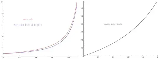

As mentioned by @Binjiu, we can give a sharper bound by using directly: $$\forall s,t>0,\ \frac{h(t)}{h(s)}\le \begin{cases} 1 & \text{if $t\le s$} \\ t/s & \text{if $t>s$} \end{cases}$$ This yields \begin{align} J&\le\int_0^{\infty}\int_0^{s} e^{-t}e^{-s}dtds+\int_0^{\infty}\int_s^{\infty} t^r s^{-r}e^{-t}e^{-s}dtds\\ &=\frac{1}{2}+\int_0^{\infty}\gamma(1-r,t)t^{r}e^{-t}dt\tag{3}\\ &=1+r\sum_{n=0}^{\infty}\frac{(-1)^n}{n+1-r}\\ &=1+\frac{r}{2}\left(\psi\left(1-\frac r2\right)-\psi\left(\frac {1-r}2\right)\right)\tag{4} \end{align} $(3):$ Lower incomplete Gamma function, $$\gamma (1-r,t)=\int_0^ts^{-r}e^{-s}ds=-r\gamma (-r,t)-t^{-r}e^{-t}$$ $$\gamma (-r,t)=t^{-r}\sum_{n=0}^{\infty}\frac{(-1)^{n}t^{n}}{n!(n-r)}$$ $(4):$ Digamma function, $$\psi\left(\frac {z+1}2\right)-\psi\left(\frac {z}2\right)=2\sum_{n=0}^{\infty}\frac{(-1)^n}{n+z}$$ Below is the comparison of these two bounds. The maximum difference is $\ln2$ as $r\to1$. enter image description here
Aforest
  • 2,755
  • That's excellent. – Binjiu Feb 11 '18 at 02:10
    By improving a bit of your method, $$ \dfrac{h\left(t\right)}{h\left(s\right)}\leq1\text{ if }t\leq s;\dfrac{h\left(t\right)}{h\left(s\right)}\leq\dfrac{t}{s}\text{ if }t\geq s, $$ we obtain the sharper estimate in the RHS $$ \dfrac{1}{4}+\dfrac{r}{8}\left(H\left(-\dfrac{r}{2}\right)-H\left(-\dfrac{r}{2}-\dfrac{1}{2}\right)\right). $$ Here $H$ is the "Harmonic Number". (The calculation is due to Mathematica.) – Binjiu Feb 11 '18 at 08:57
