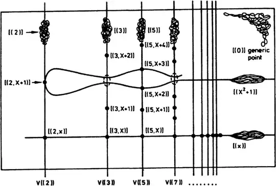

My professor said that ramified primes above $\mathfrak{p}$ are those points $\mathfrak{q}_{i}\in X$ where the fiber over $\mathfrak{p}$ meets $X$ in a tangent point (I understand that by fiber he means the vertical line above $\mathfrak{p}$ when we picture $Y$ as a straight line). I tried to match this interpretation with the example of $A=\mathbb{Z}$ and $B=\mathbb{Z}[i]$, based on the picture of $\text{Spec}(\mathbb{Z}[X])$ of Mumford:
Prime ideals in $\mathbb{Z}[i]=\mathbb{Z}[X]/(X^{2}+1)$ should correspond to prime ideals containing $(X^{2}+1)$. That is, they should correspond to points in the curve $V(X^{2}+1)$ drawn in the picture.
The picture above $(2)$ matches this interpretation perfectly, since $(2)$ ramifies in $\mathbb{Z}[i]$. And so does the picture above $(5)$, since $(5)$ splits into two primes in $\mathbb{Z}[i]$. But now I have a problem with the picture above $(3)$. There should be only one point, namely $(3,X^{2}+1)\in X$, but I guess Mumford just doesn't draw it. But even if he did, how would he draw this point without creating a singularity on the curve? Because, being the spectrum of a Dedekind domain, $X$ should be a regular curve, right? So how would we draw this point?
But if you draw this point in the naive way, introducing a singularity, suddenly the residue degree seems to make some geometric sense to me: it seems to be the number of parameters that we need to describe the curve around the corresponding point. How much of this naive impression is true? Is this just a coincidence? Because algebraically this doesn't make much sense to me. One should be able to describe the curve locally with a single parameter, because all the local rings are DVR. I will try to summarize all these doubts in the following question:

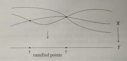

Finally, if possible, I would like to hear some clarification comments on the source that started all these doubts (initially I was naively happy with my professor's interpretation): Neukirch's Algebraic Number Theory. In chpater I, Section 13 (One-dimensional Schemes) he draws this ramification situation:
I have several problems with this picture.
  • Shouldn't $X$ be a regular curve?
  • Why aren't the ramification points tangent, as my professor claimed them to be?
  • If this is really the picture, how do we distinguish geometrically between inert points and ramification points? For example, the point on the right. Is it inert or is it ramified?
Neukirch says that this picture is only a fair rendering of the algebraic situation when the residue fields in $A$ are algebraically closed, but this doesn't help much to answer the previous questions.

Now let's have a look at the second picture. I remember that when I first met them, I asked myself questions similar to yours.
  • Yes $X$ should be regular, what you see is not $X$.
  • Inertia is not represented at all, this is a picture of complex points.
  • What looks like a singularity is a representation of a point where locally the map $X\rightarrow Y$ is given by $z\mapsto z^e$ where $e$ is the number of branches going through the point.
The idea of this diagram is to represent the behavior of a solution of an equation $P_{y_0}(x)=0$ where $y_0$ varies.
So take again the parabola $y=x^2$. A diagram of the situation has an X shape. Let $y_0\in Y$ be any point (except 0). Then there is above two solutions to the equation $x^2=y_0$ (remember that we look at complex point and we forgot about inertia). Choose one, say $x_0=\sqrt{y_0}$. Then as $y_0$ varies, $x_0$ varies continuously, until we reach $y_0=0$. Then if $y_0$ keeps moving $x_0$ can choose two different paths. We have an embranchment point. And that is why we may want to draw it with a singularity.
If we want to add inertia, we could imagine points like those of Mumford's picture : inert primes do not make embranchment points, so there should be several line which does not meet through a single point (single because we have only a single prime to represent several points in an algebraic extension). This is what you see above $(3)$ in Mumford's picture for example.
