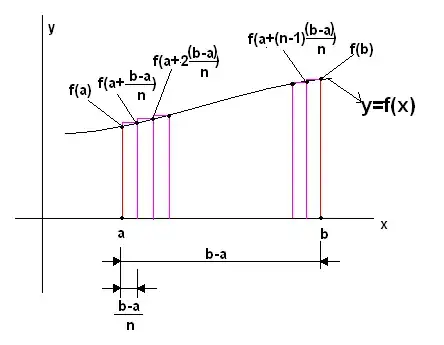

$f(x)$ is continuous function.
"The net signed area between $x=a,x=b, y=0$ and $y=f(x)$" is defined as $\int _a^b {f(x) dx}$
And also we can find the same result with sum of endless small rectangulars areas.
"The net signed area between $x=a, x=b, y=0$ and $y=f(x)$"$=\lim_{n\to\infty} \frac{b-a}{n}\sum \limits_{k=1}^n f(a+\frac{k(b-a)}{n}) $
Thus we can write
$$\int _a^b {f(x) dx}=\lim_{n\to\infty} \frac{b-a}{n}\sum \limits_{k=1}^n f(a+\frac{k(b-a)}{n}) \tag 1$$
$$ \sum \limits_{k=1}^n f(a+\frac{k(b-a)}{n})=f(a+\frac{(b-a)}{n})+f(a+\frac{2(b-a)}{n})+f(a+\frac{3(b-a)}{n})+....+f(a+\frac{(n-2)(b-a)}{n})+f(a+\frac{(n-1)(b-a)}{n})+f(b)$$
$a+\frac{(n-1)(b-a)}{n}=a+b-a-\frac{(b-a)}{n}=b+\frac{(a-b)}{n}$
$a+\frac{(n-2)(b-a)}{n}=a+b-a-\frac{2(b-a)}{n}=b+\frac{2(a-b)}{n}$
If we rewrite the sum from end to beginning.
$$ \sum \limits_{k=1}^n f(a+\frac{k(b-a)}{n})=f(b)+f(b+\frac{(a-b)}{n})+f(b+\frac{2(a-b)}{n})+f(b+\frac{3(a-b)}{n})+....+f(b+\frac{(n-2)(a-b)}{n})+f(b+\frac{(n-1)(a-b)}{n})+f(a)=\sum \limits_{k=1}^n f(b+\frac{k(a-b)}{n}) $$
$$ \sum \limits_{k=1}^n f(a+\frac{k(b-a)}{n})=\sum \limits_{k=1}^n f(b+\frac{k(a-b)}{n}) \tag 2$$
Let's change limits in the integral from $b$ to $a$.
$$\int _b^a {f(x) dx}=\lim_{n\to\infty} \frac{a-b}{n}\sum \limits_{k=1}^n f(b+\frac{k(a-b)}{n})=-\lim_{n\to\infty} \frac{b-a}{n}\sum \limits_{k=1}^n f(b+\frac{k(a-b)}{n}) \tag 3$$
If we use the result that we got above in tag 2.
$$-\lim_{n\to\infty} \frac{b-a}{n}\sum \limits_{k=1}^n f(b+\frac{k(a-b)}{n}) =-\lim_{n\to\infty} \frac{b-a}{n}\sum \limits_{k=1}^n f(a+\frac{k(b-a)}{n})\tag 4$$
$$\int _b^a {f(x) dx}=-\lim_{n\to\infty} \frac{b-a}{n}\sum \limits_{k=1}^n f(a+\frac{k(b-a)}{n}) \tag 5$$
We can combine with Equation $(1)$ and we get the relation that we wanted to find.
$$\int _b^a {f(x) dx}=- \int _a^b {f(x) dx}\tag 6$$
