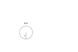

The proof I see most often is the parallellogram proof, cutting the circle radially into ever smaller wedges and joining them together to approximate a parallellogram:
It leaves the question of convergence open; do these approximations of parallellograms converge to a rectangle with side lengths $r$ and $\pi r$ as we take ever smaller wedges? It turns out that they do and the argument can be made rigorous, but to the critical lay person this need not be clear from the picture.
Triangle proof
Another proof I have seen quite often is the triangle proof, cutting the circle into ever thinner concentric rings and unwrapping them to approximate a right triangle:
Again this leaves the question of convergence; do these approximations of right triangles converge to a right triangle of height $r$ and base $2\pi r$? Again it turns out that they do and the argument can be made rigorous, but again to the critical lay person this need not be clear from the picture.

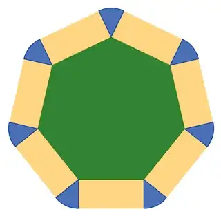

$(\delta)$ also follows from this pictorial argument, where the outer "polygon" is obtained by summing (in the set-sense) a small disk to the inner polygon:
It is visually clear what happens if we let the number of sides go to $+\infty$ while preserving the circum-radii of the inner and outer polygon.

    @Servaes: consider two concentric circles with radii $r,r+\varepsilon$ and a set of orthogonal vectors to the boundary of the inner circle. The area of the annulus exactly equals $\varepsilon L(r) + A(\varepsilon)$. Have you ever seen the proof of the isoperimetric inequality through the Brunn-Minkowski inequality? See pages $111+$ of my notes. – Jack D'Aurizio Jan 05 '18 at 18:36
  • I like the picture. Can it be used to argue Michael Behrend's premise? Regardless, interesting answer. (+1) – CopyPasteIt Jan 07 '18 at 20:49
  • @MikeMathMan: convex boundaries are always well-approximated by polygons, hence yes, it can be used to prove Micheal's premise, too. – Jack D'Aurizio Jan 07 '18 at 20:55
